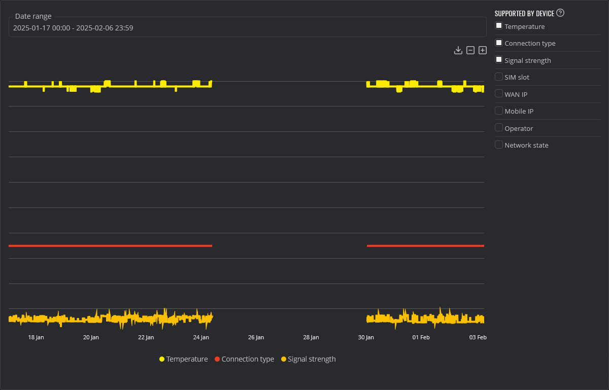

I’m currently facing the issue that I have a TRB140 running at a customer, and after a few days it does not connect to the RMS anymore, but still has an internet connection.
The screenshot is from yesterday (Feb 6th) and the RMS sees activity until the 3rd. It also stopped communicating with the RMS on the 24th of January until it was restarted on the 30th. To reiterate, the device still works and has access to the internet.
Firmware is TRB1_R_00.07.07.3.
The same problem occurs on other TRB140s sometimes after turning the power off and on again. The device has internet access, but does not connect to the RMS.
Any idea why this is happening?
First of all, can you upgrade your router to the latest firmware version and see how it goes?
It is super difficult to troubleshoot on older versions…

I should add that the problem is usually fixed by turning the power off and on again.
I will update the firmware. Of course, the device will have to be restarted so that I can gain access. But that also means that the problem will be fixed temporarily.
Okay but let’s observe.
The changelog between your version and the latest one is h.u.g.e.

It’s hard to say, this problem occurs very infrequently. But we haven’t had the issue since.
