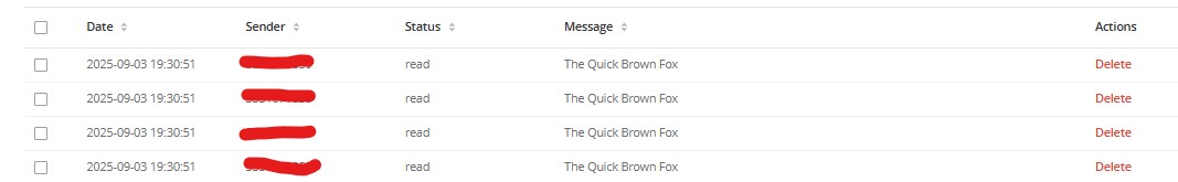

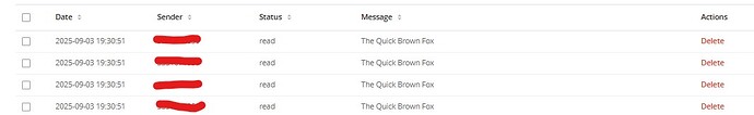

When I send from my mobile to the Teltonika, several copies of the message are received..It seems to vary. The attachment shows 4 in this case.
