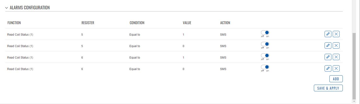

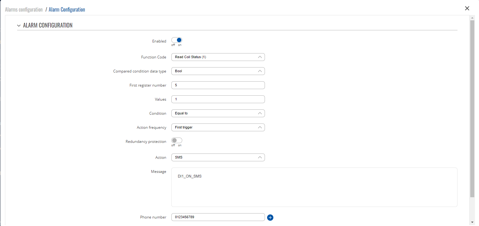

Hi all members, I’m having the issue after rebooting device TRB140. I configured a variable for 2 alarm states. One is normal (value = 0) and one is alarm (value = 1). Assuming a system is normal with no alarms, when the TRB140 has power fail and restarts or reboots, alarms with a value of 0 (normal) will be sent again or even happened when I was configuring SMS on Web UI after clicking “Save & Apply”.
Is this problem due to the way the device works or is it related to the firmware? I have also attached some configuration images below.

Please note that this is the normal behaviour of the router. Its because if the router is restarted or even while configuring, the initial steps of the router is to check the registers and send the alarm. This will count as the “First Trigger” and hence the sms will be sent.
This is the same behaviour in the Latest FW 7.6.2 too.
