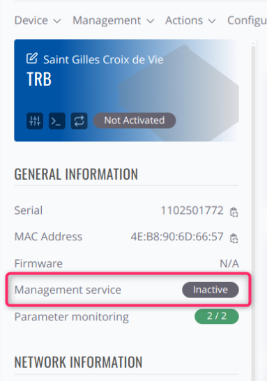

My TRB140 device is not able to connect to RMS. The behaviour is quite strange:

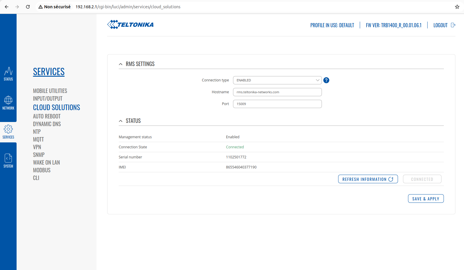

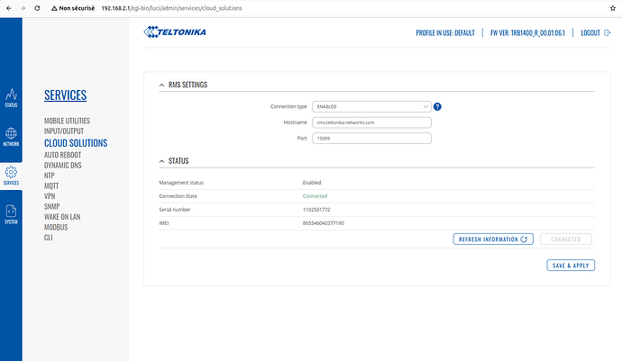

  • when I connect directly to the device through LAN, in the “Cloud solutions” section, the device’s status is “Enabled”, and the connection state “Connected”

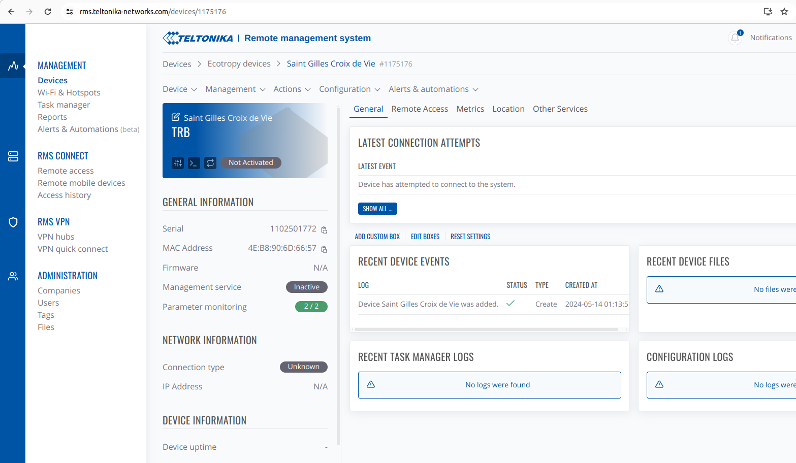

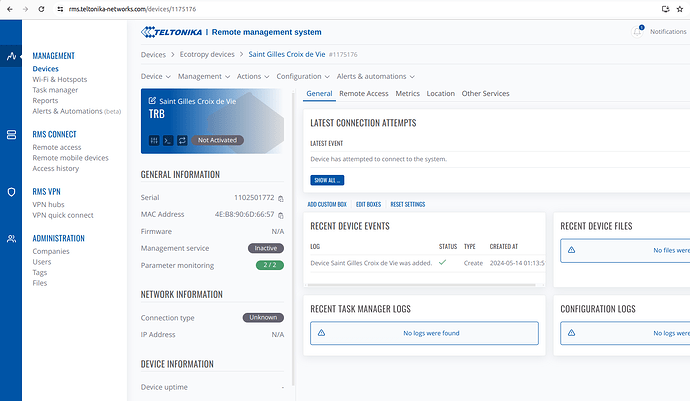

  • however, in RMS, the device remains “not activated”
    I tried several times to unregister and register again, the situation remains the same.
What could be wrong ?

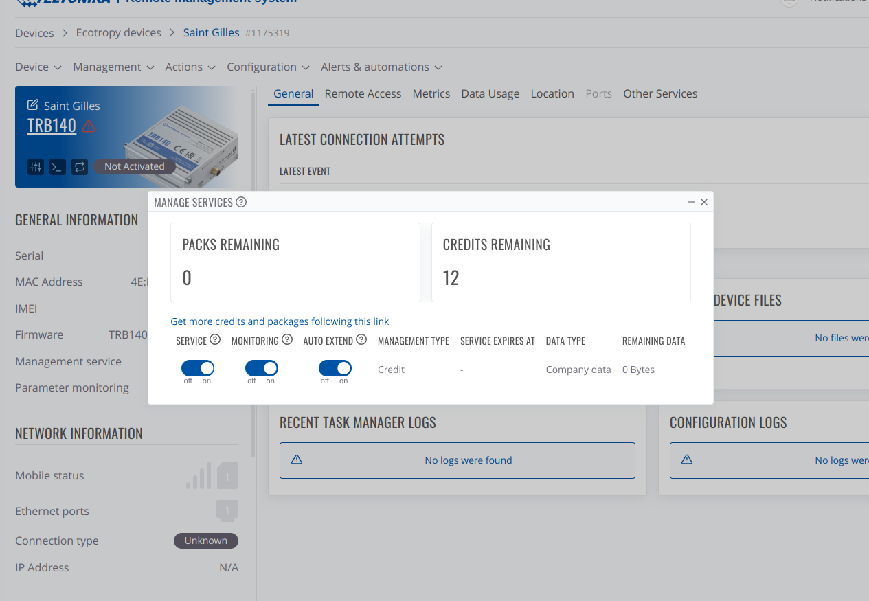

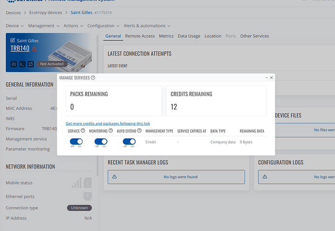

Yes, I think so : I bought 12 credits for the company and activated it.
From what I read, having a “pack” is not mandatory as far as I have credits. Am I right ?

The device is able to reach Teltonika’s RMS system, but it’s not able to reach your company RMS. From what you have writen I can see that you already have tried multiple times to register and unregister.
Could you in your Company RMS portal go to “+Add”.
Make sure that the correct company is selected in the section “company”. (You should select the company that has the RMS credits.)
Make sure that you select TRB in the section “Device series”.
Add your hostname, serial number, IMEI and the password that you used to login to the TRB140 device itself. If everything is correct it should be added into your company RMS
You can find both the serial number and the IMEI number under the TRB140 device.
