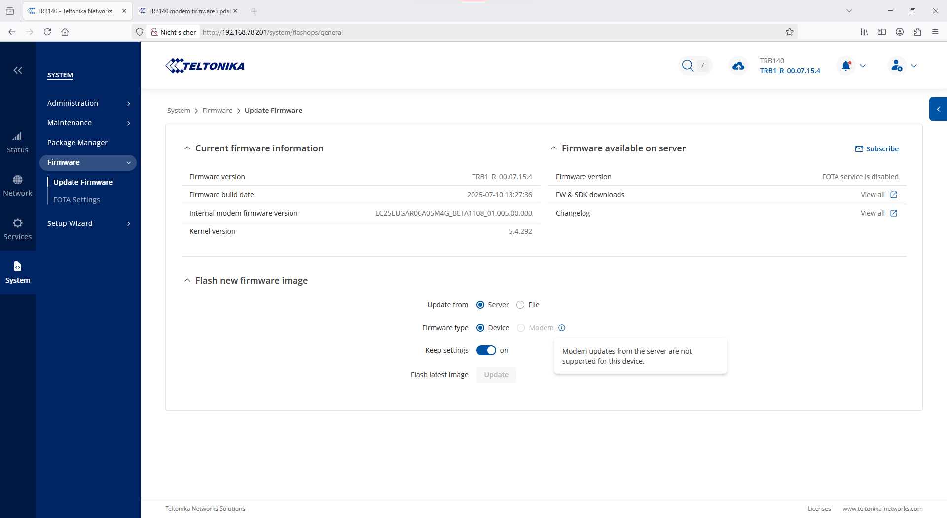

The WebUI tells me: “Modem updates from the server are not supported for this device.”

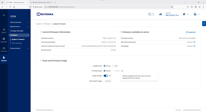

My TRB140 device’s WebGUI reports that modem firmware update is not possible on this device. This is the main reason for my inquiry.
More precisely: “Modem updates from the server are not supported for this device.“
Could you please provide a screenshot? I’d like to forward it to the RnD for review.
It’s a mouse-over dialog at the (i) symbol. “Modem” cannot be selected, it’s greyed out.
