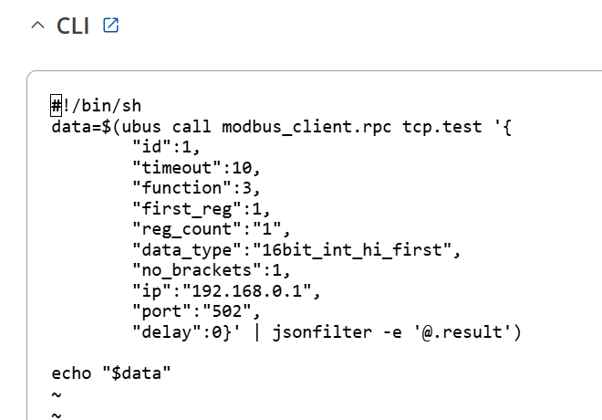

i am trying to run this script on trb140 (fw version TRB1_R_00.07.12) but it returns “communication error” message
any explanation about it please

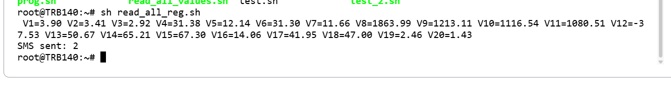

i couldn’t execute a custom script via sms utility, while i can execute it via the CLI terminal
