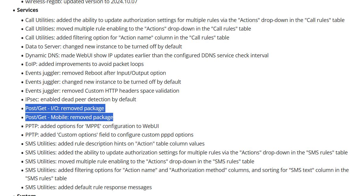

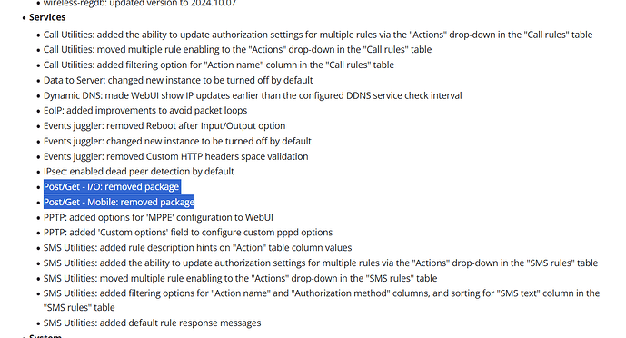

I have TRB140 with firmware version TRB1_R_00.07.06.6 where i could configure the SMS Gateway Post/Get settings with a username and password. But after upgrading to newer version i.e. > TRB1_R_00.07.15.1, these settings are missing. How can i change the username and password or enable/disable the post get settings again after the firmware upgrade?
With the firmware version 7.14 POST/GET has been removed as you can see in the changelogs here:
You can find more details here:
As an alternative, you can utilize our API requests:
