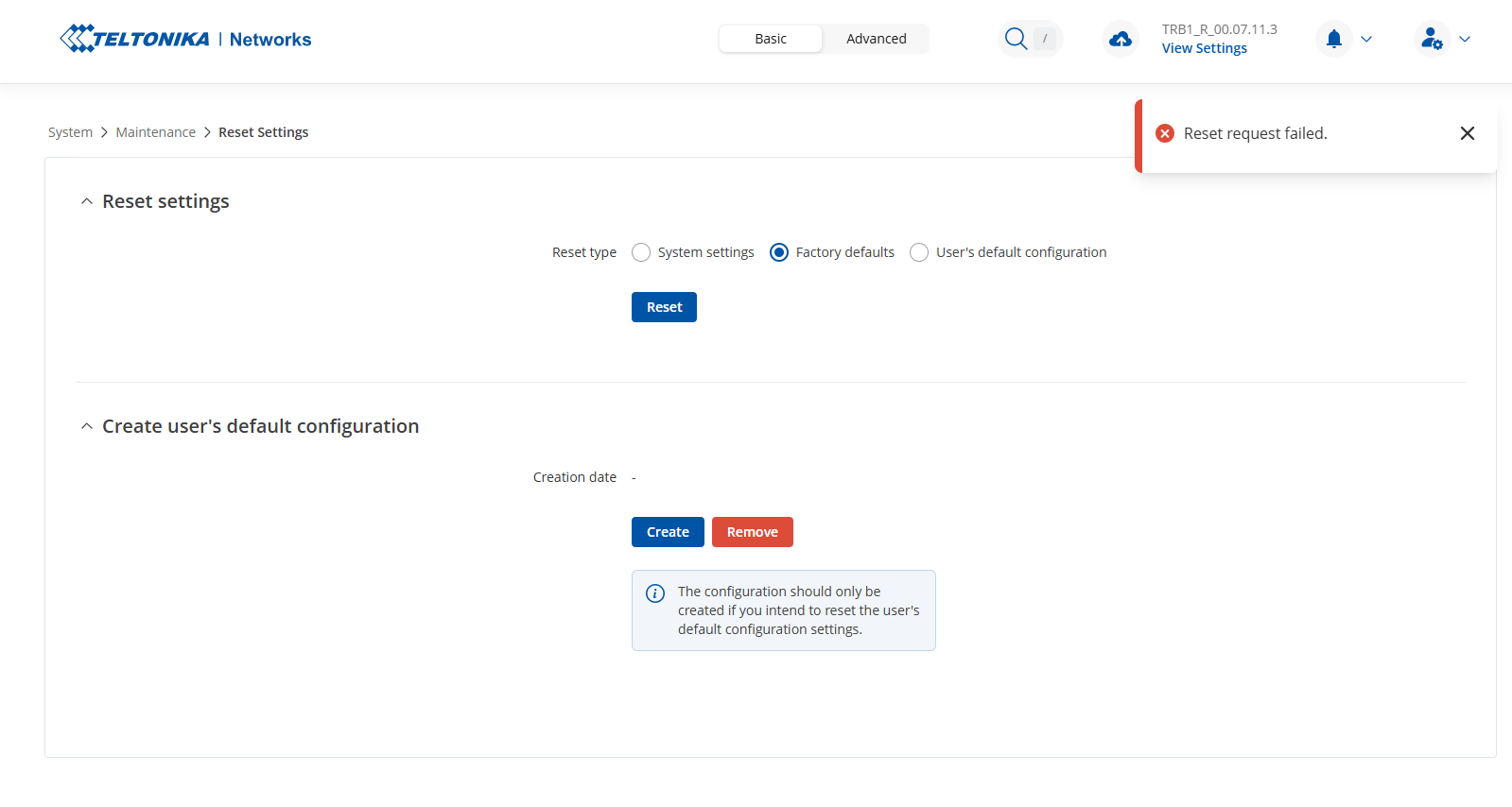

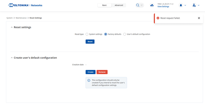

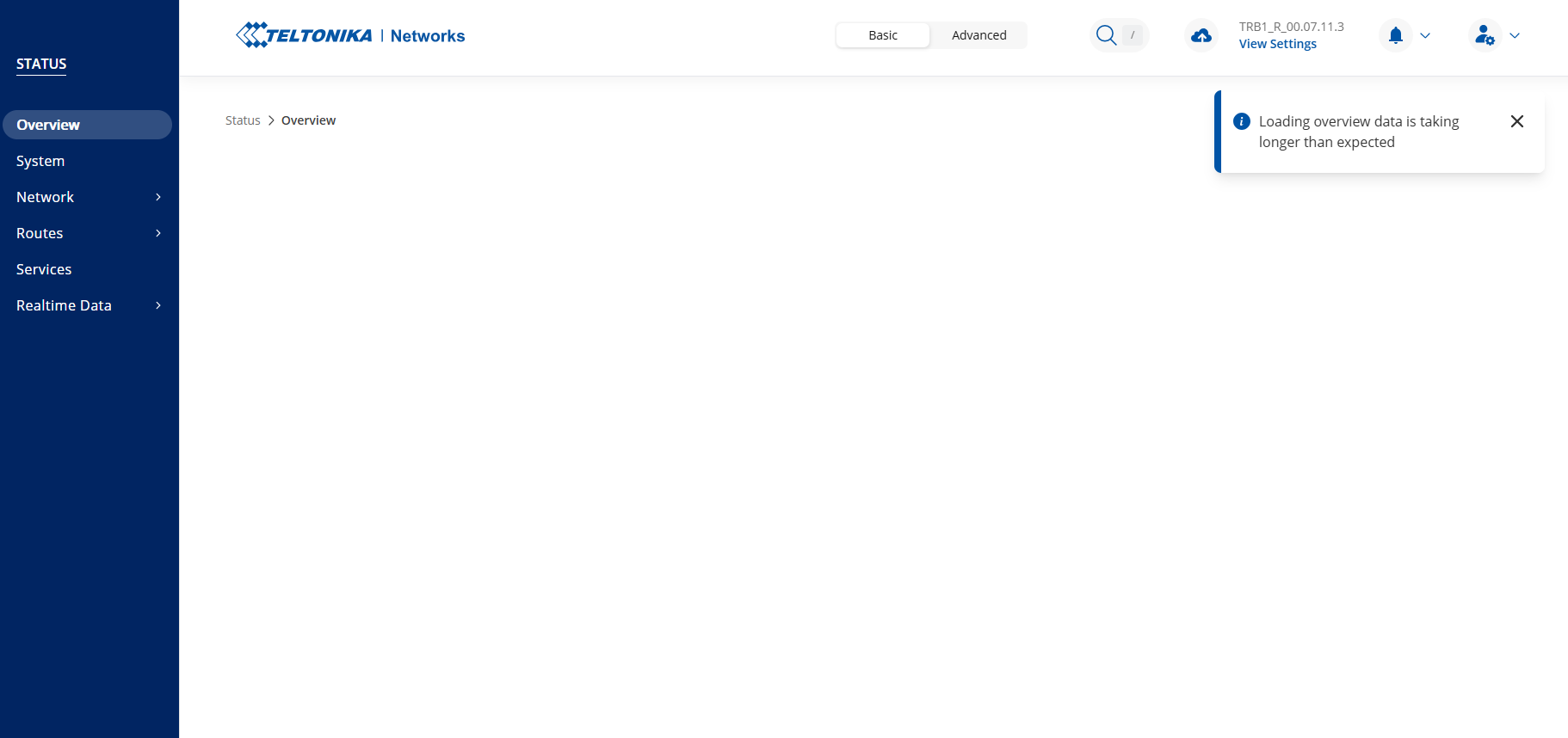

I also decided to update the firmware from the legacy TRB140X_R_00.01.06.1 version, and the initial upgrade went smoothly. Unfortunately, after updating to the latest version TRB1_R_00.07.13.1_WEBUI, all functionalities stopped working, including OpenVPN, which I intended to use. Even performing a factory reset results in an error. Btw internet connection is fine.

Good afternoon,
If you are unable to make the device work after a regular reset, the issue may be related with flash memory. I would advise to get in touch with wherever you purchased the item, for an RMA process.
