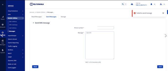

Hi, I have recently unboxed my brand new TRB140 and have been unable to send SMS in Australia. Much effort has gone into diagnosis and configuration.
Device: TRB140, firmware TRB1_R_00.07.21.1 Modem: Quectel EC25-AU, firmware EC25AUFAR06A12M4G_01.001.01.001 Carrier: Aldi Mobile (Telstra wholesale), Australia
Problem: Cannot send SMS. Australia shut down 3G in 2024, so SMS must work over IMS/LTE. Receiving SMS works, sending fails with +CMS ERROR. AT+QIMSSTAT? returns ERROR — IMS is not registering.
I’ve since contacted Quectel directly and they confirmed the firmware is outdated. They provided me with EC25AUFAR06A13M4G_01.001.01.001, which includes Telstra MBN updates and IMS fixes.

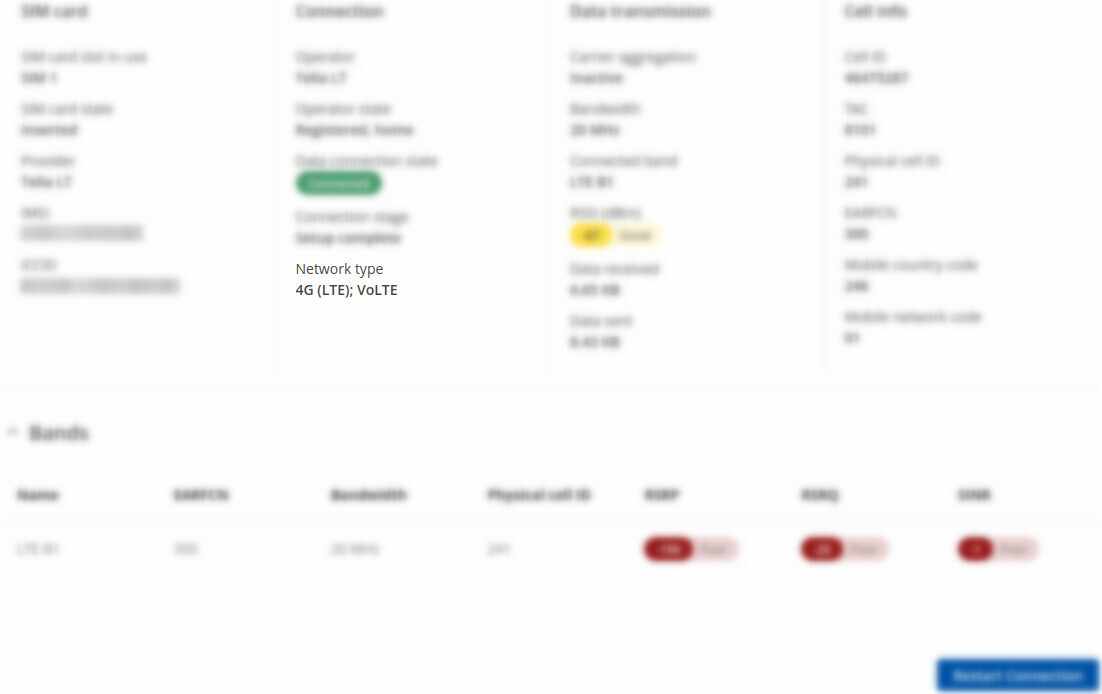

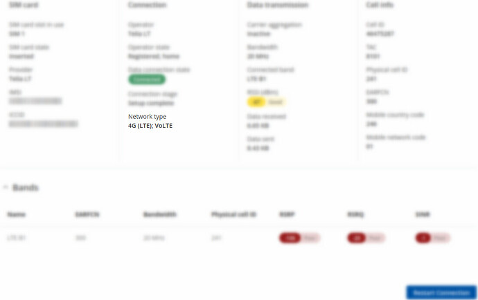

Could you please check in the Status → Network → Mobile page if VoLTE is active?

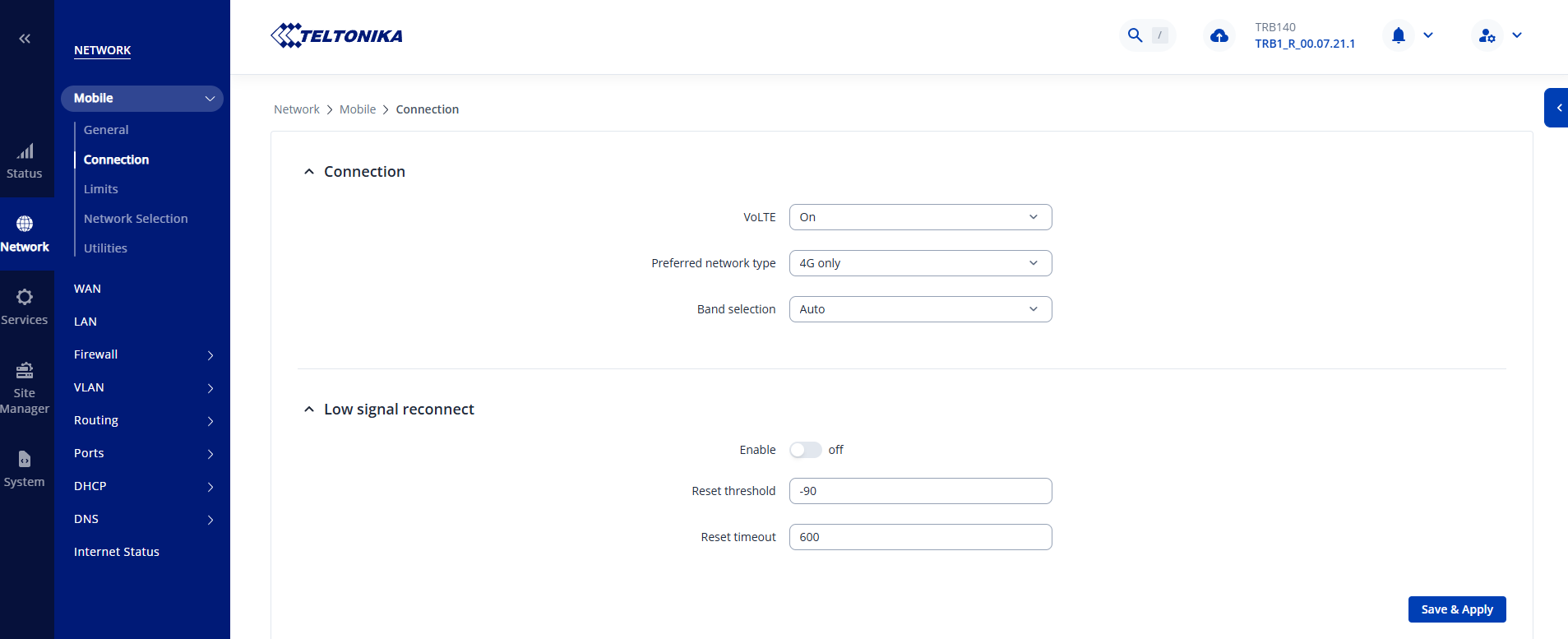

You may set it to On by navigating to Network → Mobile → Connection and then try sending an SMS
Hi Justinas,
Sure, here are my settings:

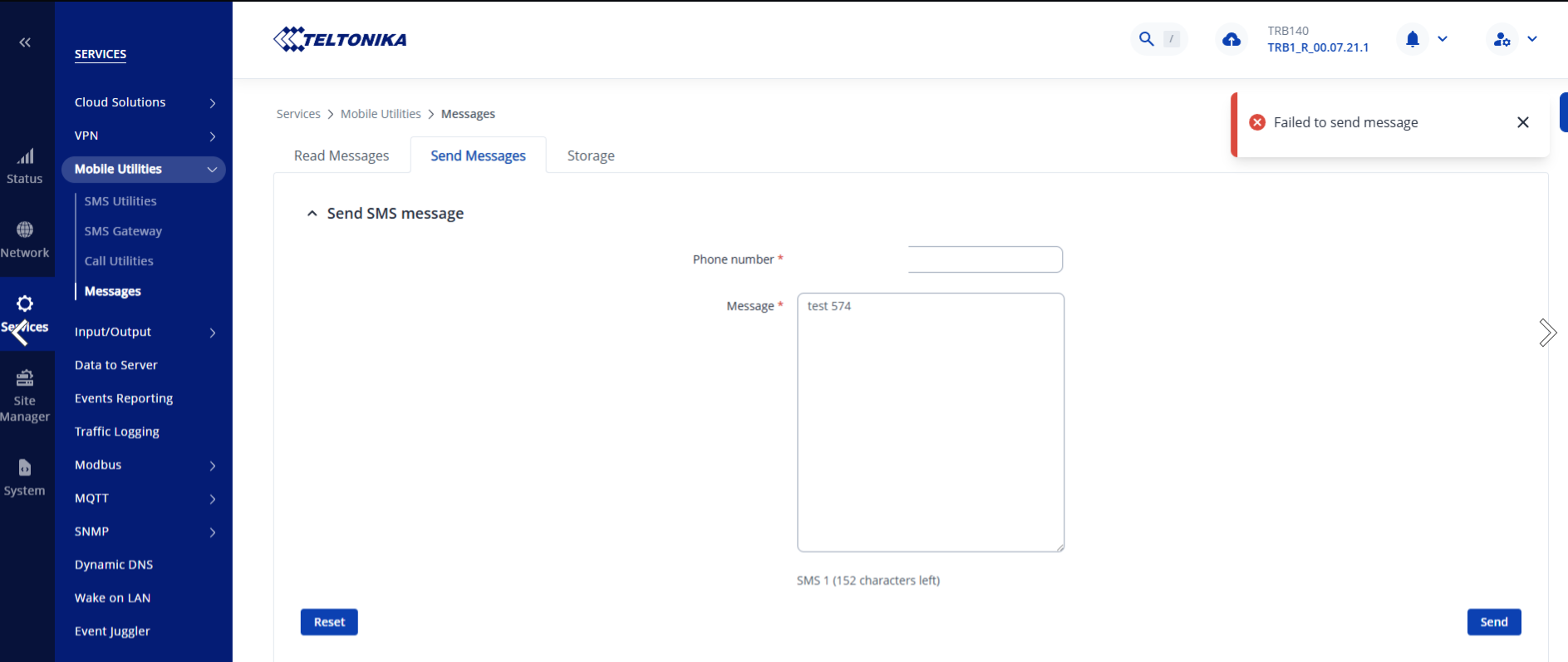

Result after a long timeout:
