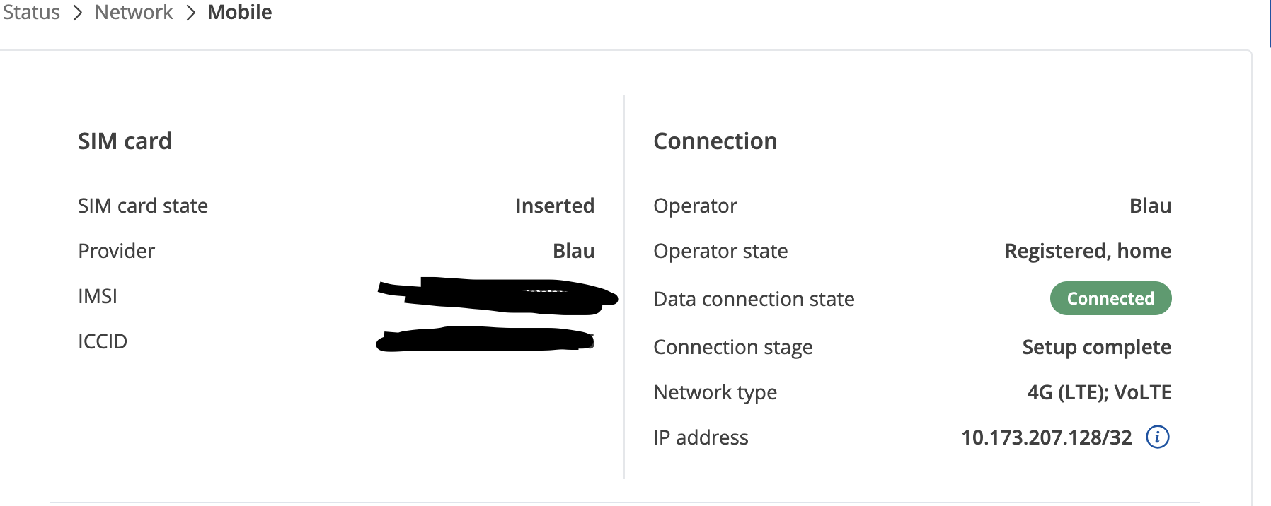

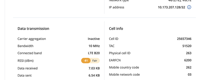

Thank you for the update and providing additional helpful information. Could you confirm whether the mobile data connection with the operator is established and the correct APN is selected? Also, please provide a screenshot from the Status → Network → Mobile page, with any sensitive/private information hidden (e.g., public IP, IMEI, ICCID, etc.). Furthermore, for testing purposes, try sending SMS through WebUI through Services → Mobile Utilities → Messages page, Send Messages tab. I assume if it is related to the issue with modem itself, it shouldn’t allow sending SMS via WebUI as well.
The Correct APN is selected the Internet works fine.
Over Service/MobileUtilites/Messanges pages ist same Problem (Failed to send Messages).
