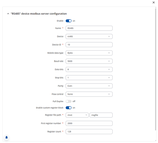

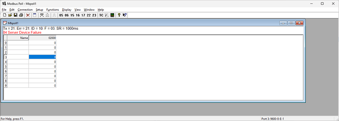

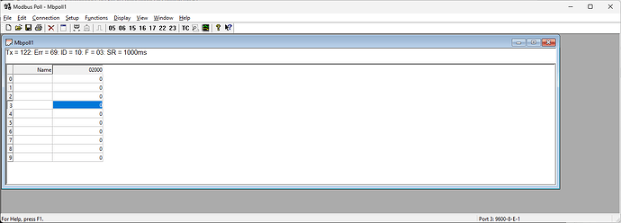

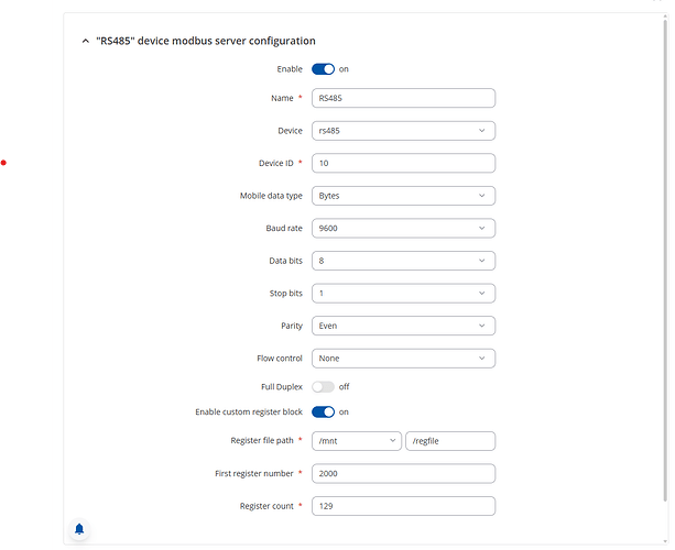

In firmware TRB1_R_00.07.16.2 (and TRB1_R_00.07.15.2) it seems as the custom register block is faulting when using more than 128 registers in the field “Register count”. When set at 128 or lower it is working as expected.
This is at 129 custom registers:
This is at 128 custom registers:
