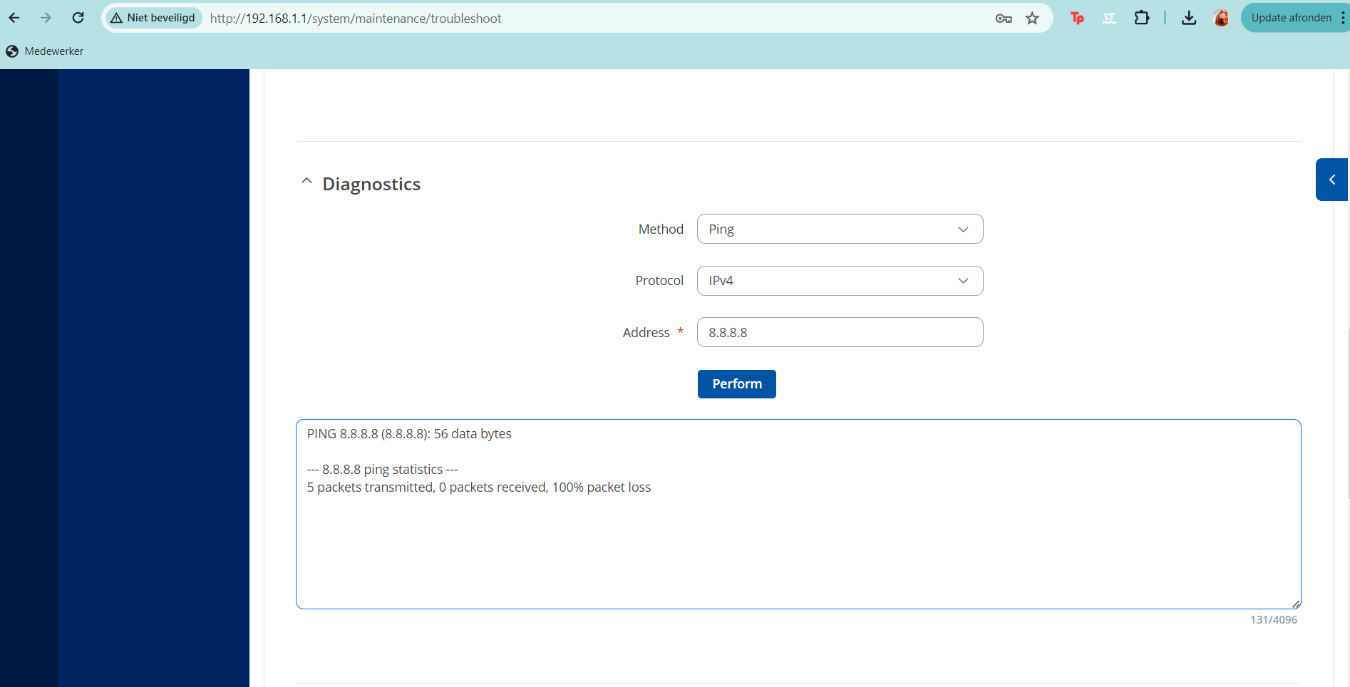

The results for pinging 8.8.8.8 are shown in the screenshots below.

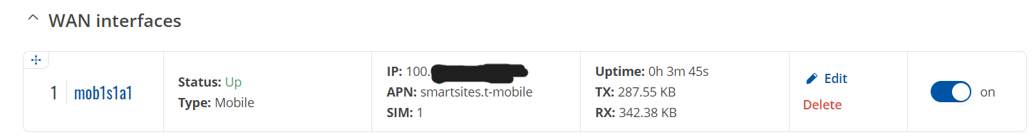

Mob1s1a1 does show an IP address , I previously had apn issues before when it was set to auto (this would lead to frequent disconnects) but it was resolved by using the provider’s custom apn.

Hello Joshpiri,
I have checked the troubleshoot files that you have provided and everything looks intact, no IP conflicts, everything is routed as intended.
What caught my eye is that the ping from router to 8.8.8.8 is not going through, so try pinging other IP’s like 1.1.1.1, if it does not go through, another option is to check if you have internet connection by writting curl icanhazip.com which will show your public IP, if you can access internet at all.
My offer would be to contact your mobile provider and check everything from their side, if the given APN indeed works on your subscription plan and that it has internet plan. Try inserting the SIM card to your mobile device and testing it if it provides internet connection for your mobile.
