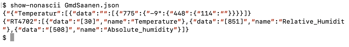

Based on the information currently available, we can confirm that the data is being received as expected through MQTT, while the HTTP payload appears to have a different or malformed structure. However, the examples alone are not sufficient to determine whether the issue originates from the TRB246 configuration, the generated HTTP request, or the receiving server.

The quotation marks shown in the forum example appear to be typographic quotation marks rather than the standard quotation marks used in JSON. However, we cannot determine from the forum representation whether these characters were actually transmitted by the router or introduced during copying or display. A raw HTTP capture will help us clarify this.
