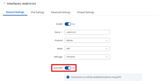

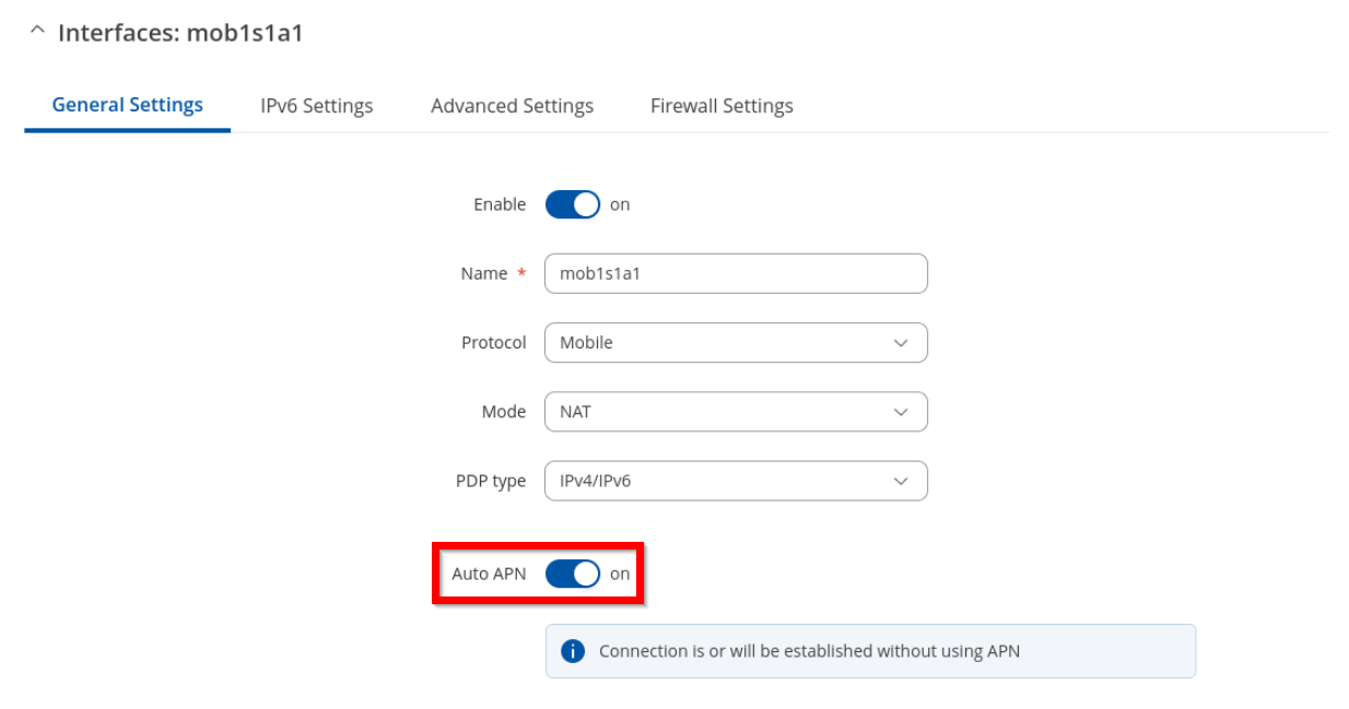

I suggest checking which APN you’re using. It seems like there might be APN issues causing your mobile data connection to be rejected.
You can find APN settings under Network → WAN. Click on “Edit” next to the active mobile interface. A new pop-up window should appear where you can disable “Auto APN” and enter the correct APN.
Thank you Marijus data connection established its working.

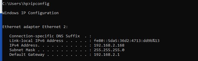

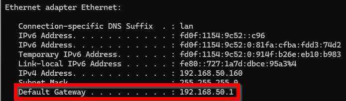

Either way, try finding out the address of your router. You can do this by opening CMD and typing ipconfig. The default gateway is the address of your router.

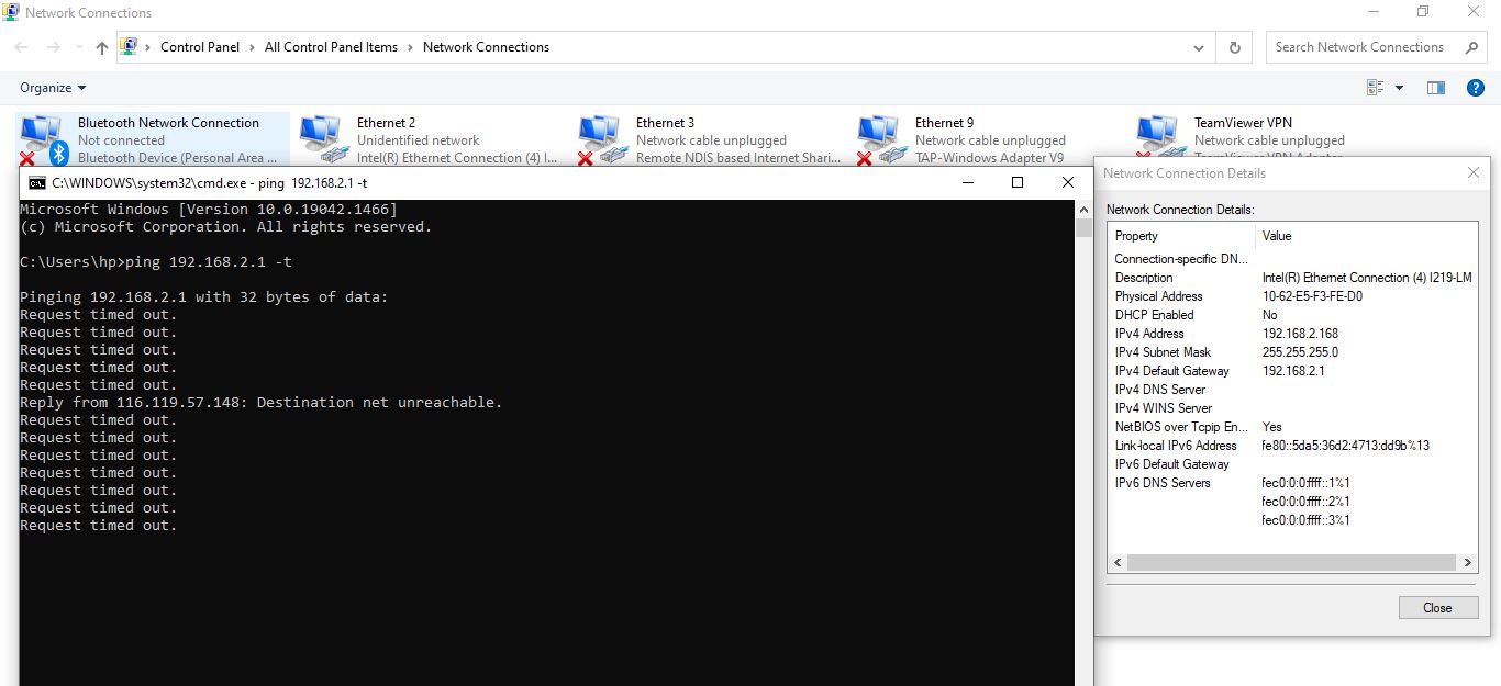

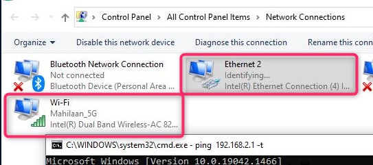

It seems from the image you provided that the TRB140 is connected, and its DHCP server is assigning an IP address to your computer. It’s puzzling why you can’t ping it. Could you provide the output of the command “ping 192.168.2.1”?
Also, since it’s the second network adapter, is your computer connected to any other network at the same time?

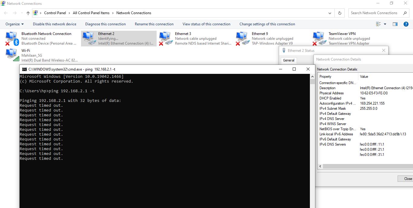

Lan is connected with TRB140 router & WIFI for internet is connected. Pls find the ping CMD for your reference

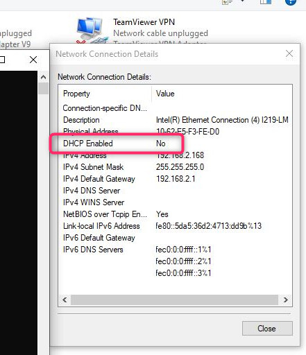

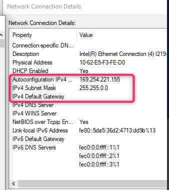

It looks like your PC is NOT getting its IP address via DHCP and your router has a different IP.
Can you make sure to set your PC to DHCP?
Then see automatically assigned Default Gateway (= your router) and try to ping it again.
now DHCP is enable. still not getting ip reply
Yes because your PC doesn’t receive an IP address from your router:

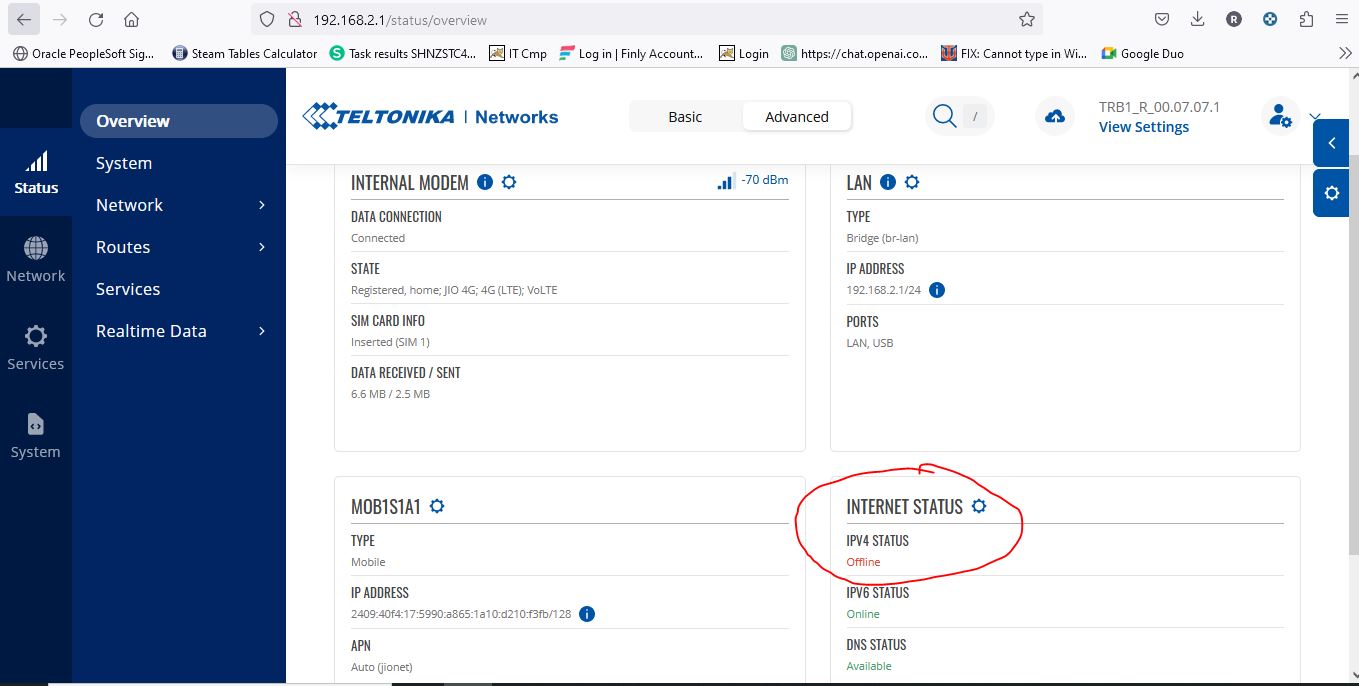

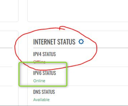

why its showing as like in IPV4. can you please tell me

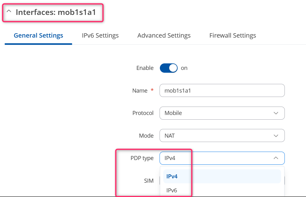

I can: because you’re online via IPv6:
To change that, set it to IPv4 only:
