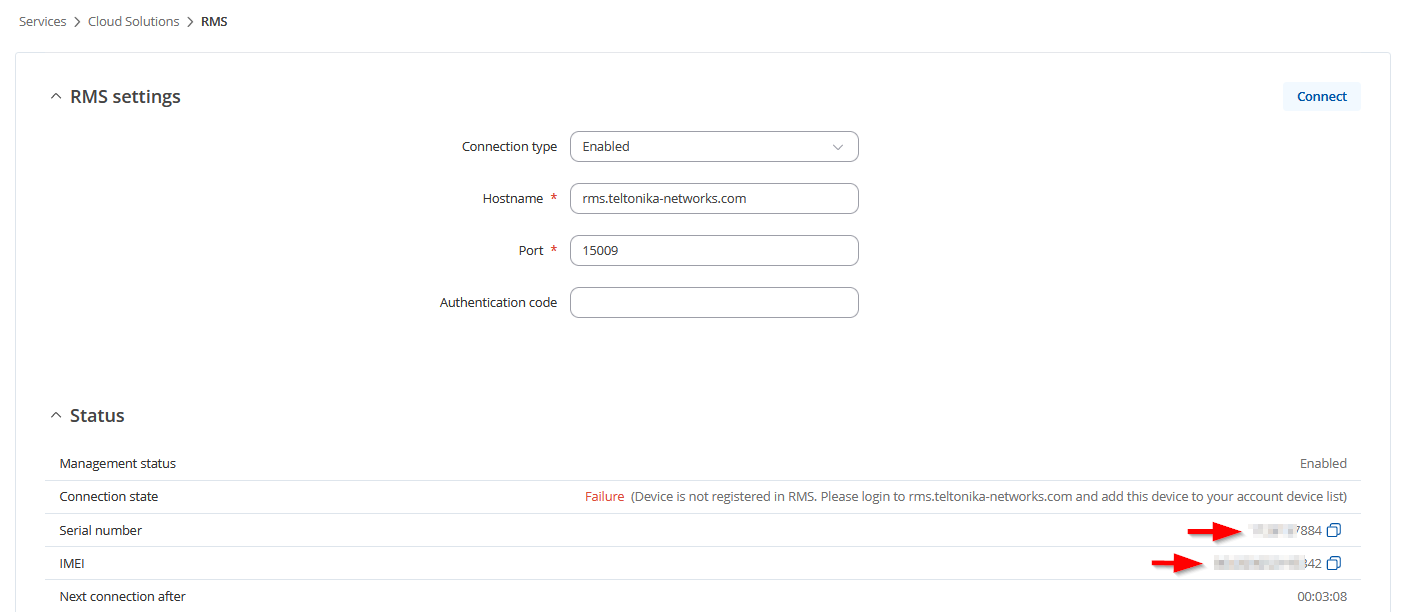

I have 3 device’s with problem to connect rms.
Please help me :slight_smile:
Before anything else, please make sure that the correct information is entered when registering your device. The easiest way to do this is by going to the device’s WebUi Services, then selecting Cloud Solutions, and finally RMS. From there, copy the information. Also, don’t forget to double-check that the password you are providing is correct.

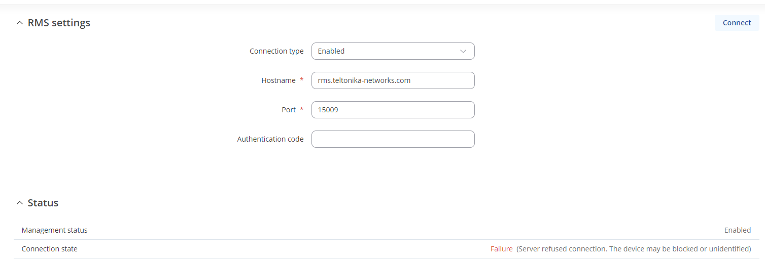

Unfortunately, the devices were not turned on for half a year.
After turning it on, I have this message.
Please help me !

If you haven’t activated any pack for these devices, you can remove them from your RMS account and then add them again.
I have a 5-year RMS contract.
