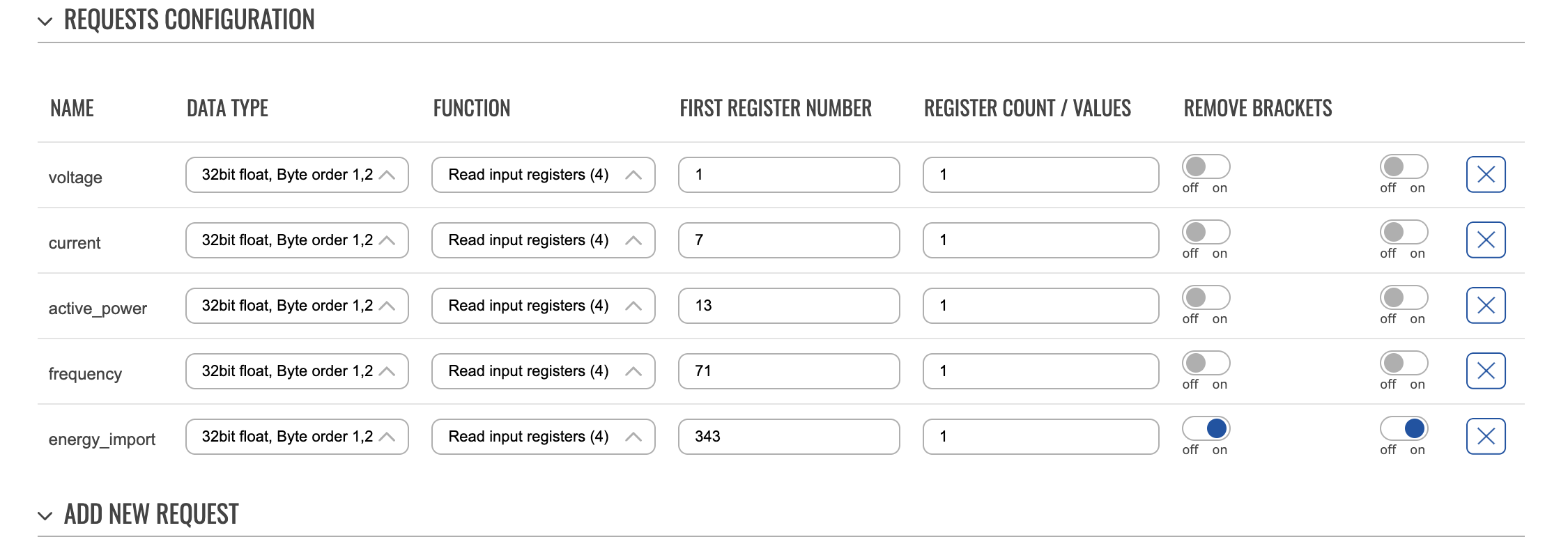

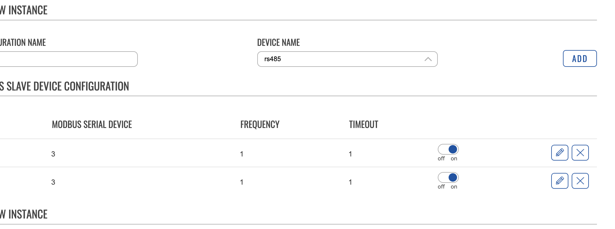

I set 1s interval in modbus >> series master >>> 1s
But modbus_db is getting 2 second intervals:

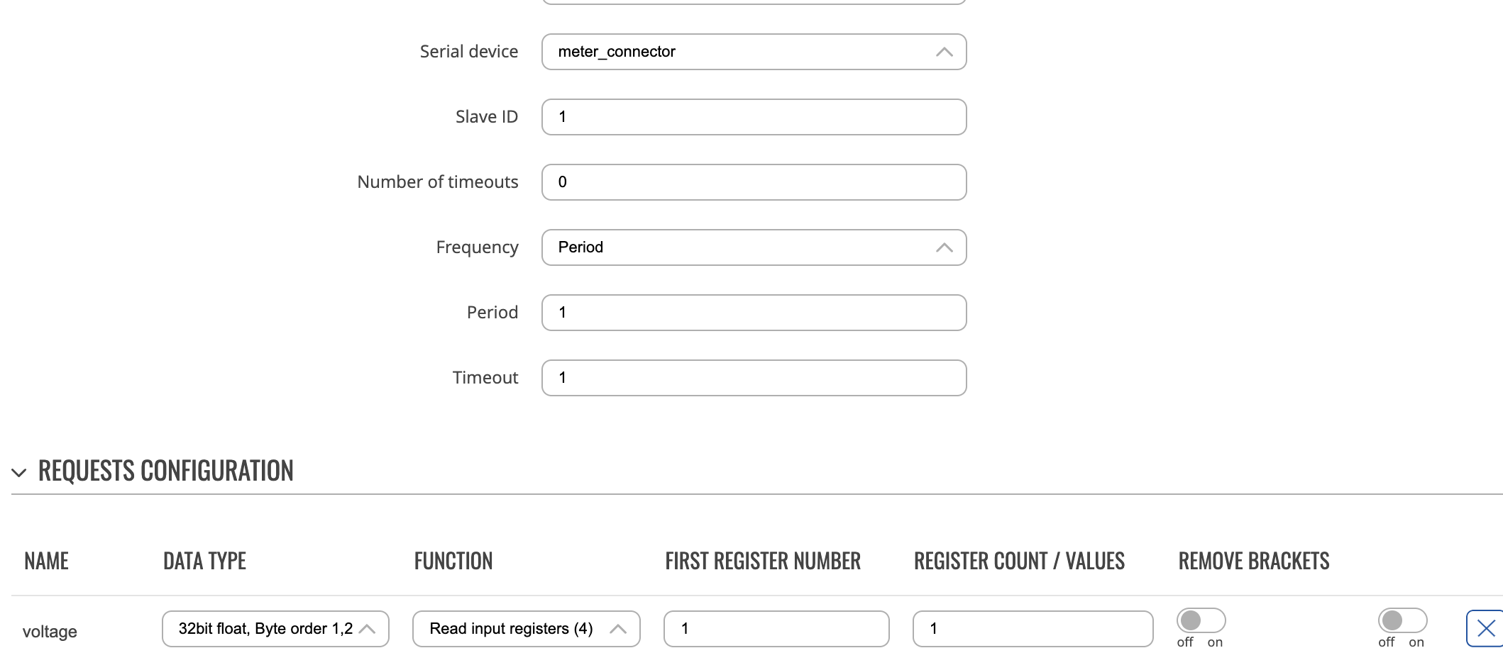

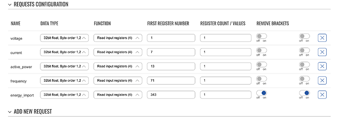

I’ve checked, and with the interval set to 1 in Modbus Master configuration, the data is returned every second for both registers read:
Perhaps your device takes longer than a second to return the values? Are you sure that the interval is set to 1 second?

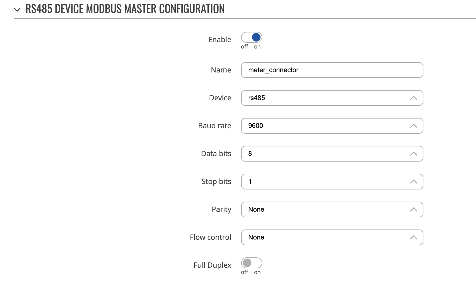

Could you also attach the Serial connection parameters?

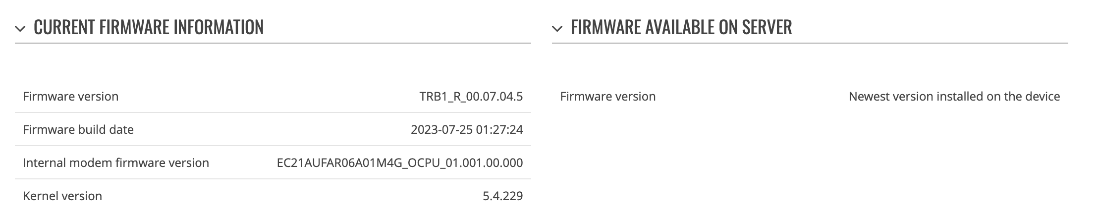

It could be that the device simply cannot return this data in 1 second. Also, what is the firmware version on your device?

The same TRB1 device can act as a slave and a master. Try reading the register 2 with the register count of 2. If the data is returned every second, the issue is most likely caused by the speed of the serial line. If your device supports it, please try increasing the baud rate and check if the issue replicates.

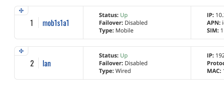

We are using rs485 to send data to device, not another wireless device. So you can only see lan instead of wan.
No, it won’t send data when baud > 9600

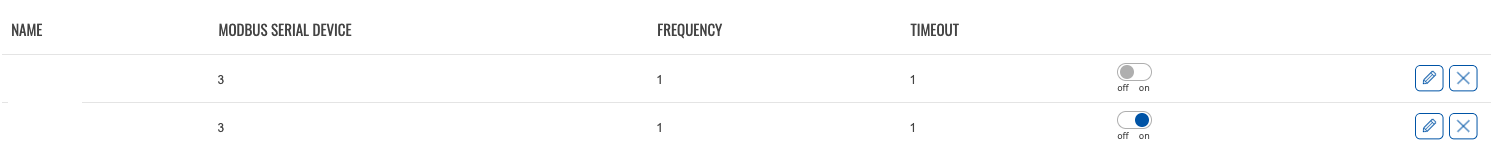

By disable one of the slave, it now can send data by one second intervals. So your advice is to change the series wire to improve the bandwitdth?

If your device supports it, I’d also suggest configuring the RS485 line for full-duplex operation, as the TRB145 supports it.
