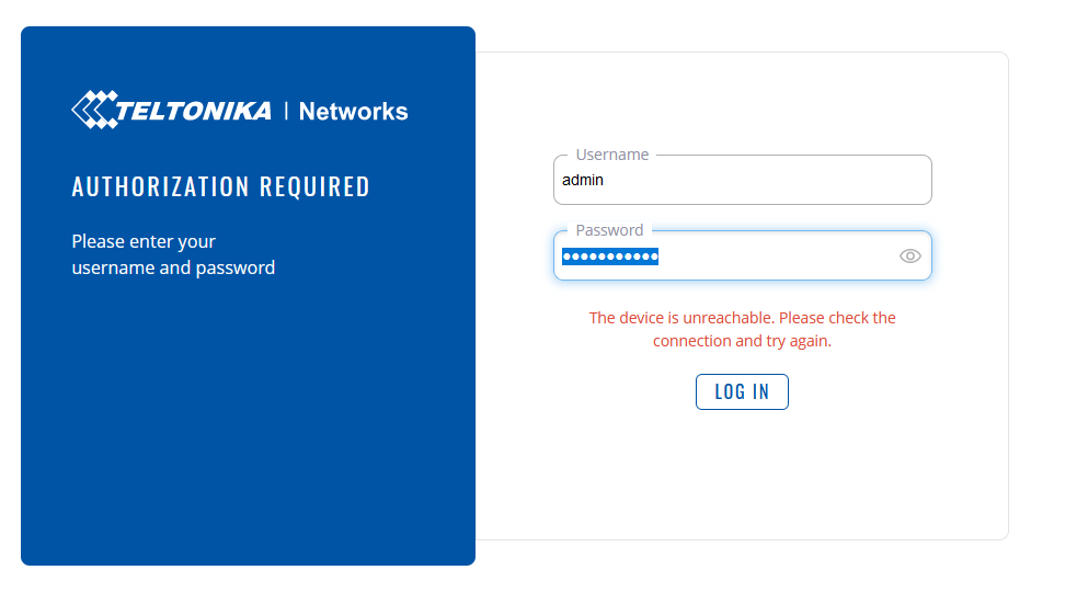

we are experiancing some issues with the RUT 955 remote access i am using the most recent Firmware R_00.07.04.5_WEBUI.bin
The device is unreachable. Please check the connection and try again.
This issue is most likely caused by a file corruption after the firmware update. Could you clarify if this issue started happening after the firmware update from an older version?
If this is the case, in order to resolve the issue that you are currently experiencing, additional provision of further confidential details is required. Hence, it is recommended that you reach out to your designated sales manager or the reseller from whom you acquired the device in question. They will be able to assist you in addressing this matter more effectively. If this is not possible, please fill out the Contact Us form here: Teltonika Networks - LTE Routers, Gateways & Modems for IoT
Yes that is what happen that i updated the new firmware and right after that i got this error i have already contacted my sales manager thank you
