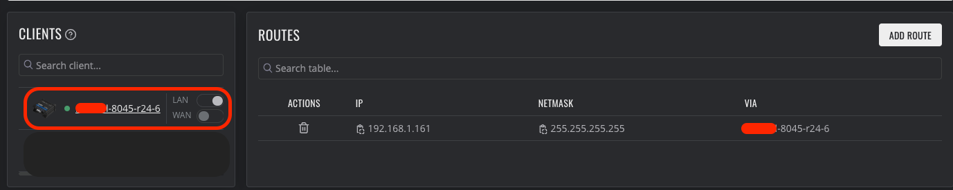

I’m having problems to connect via ssh on port 22222. My device is connected to a RUT955.
I was able to configure the VPN to connect via port 80 to our device and also to ping it, but I haven’t been able to connect through ssh. I have been following this guide and this one. When I try to connect via ssh, the command just never ends, the connection doesn’t get refused. It might have to do with the fact that the ssh port for a this device is 22222, maybe as it isn’t the default 22 it doesn’t get forwarded.

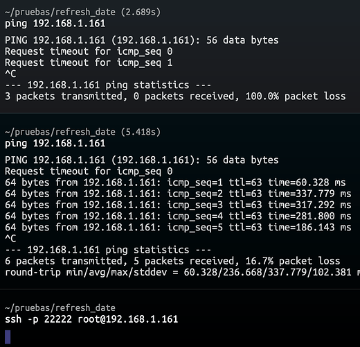

I’m not trying to ssh into my RUT955, but to another device connected to the RUT955 using VPN Hubs.
In the picture attached you can see the results of pinging without VPN (Failed), with OpenVPN connected (success) and ssh (unfinished/blocked).
For further troubleshooting, can you try to utilize RMS Connect. click Add → Auto Scan → Select the device behind RUT955 → for port number, select Other, then input 2222.
Also, there might be an option for your end device to enable remote SSH. Kindly check for the same.
Let me know if this is able to access the SSH of your device.
That worked! Thank you very much.
