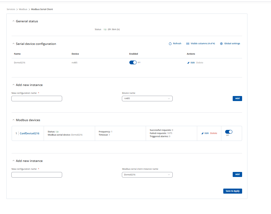

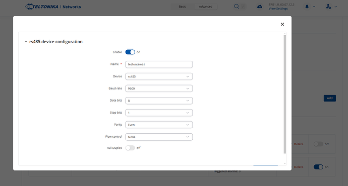

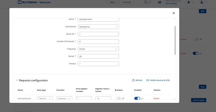

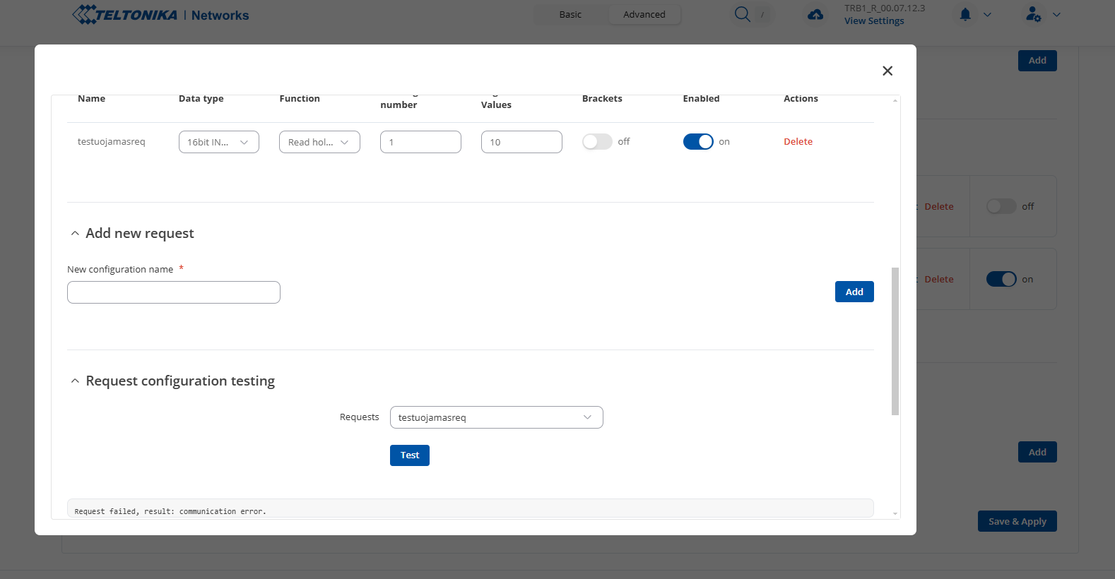

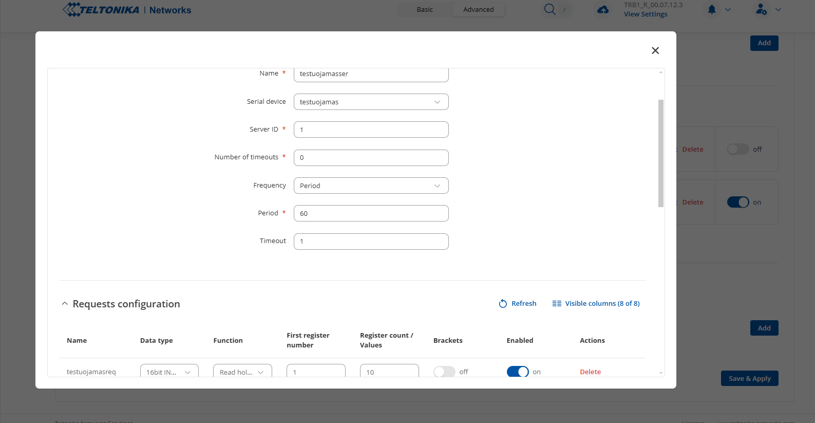

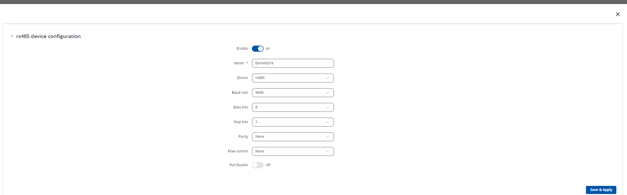

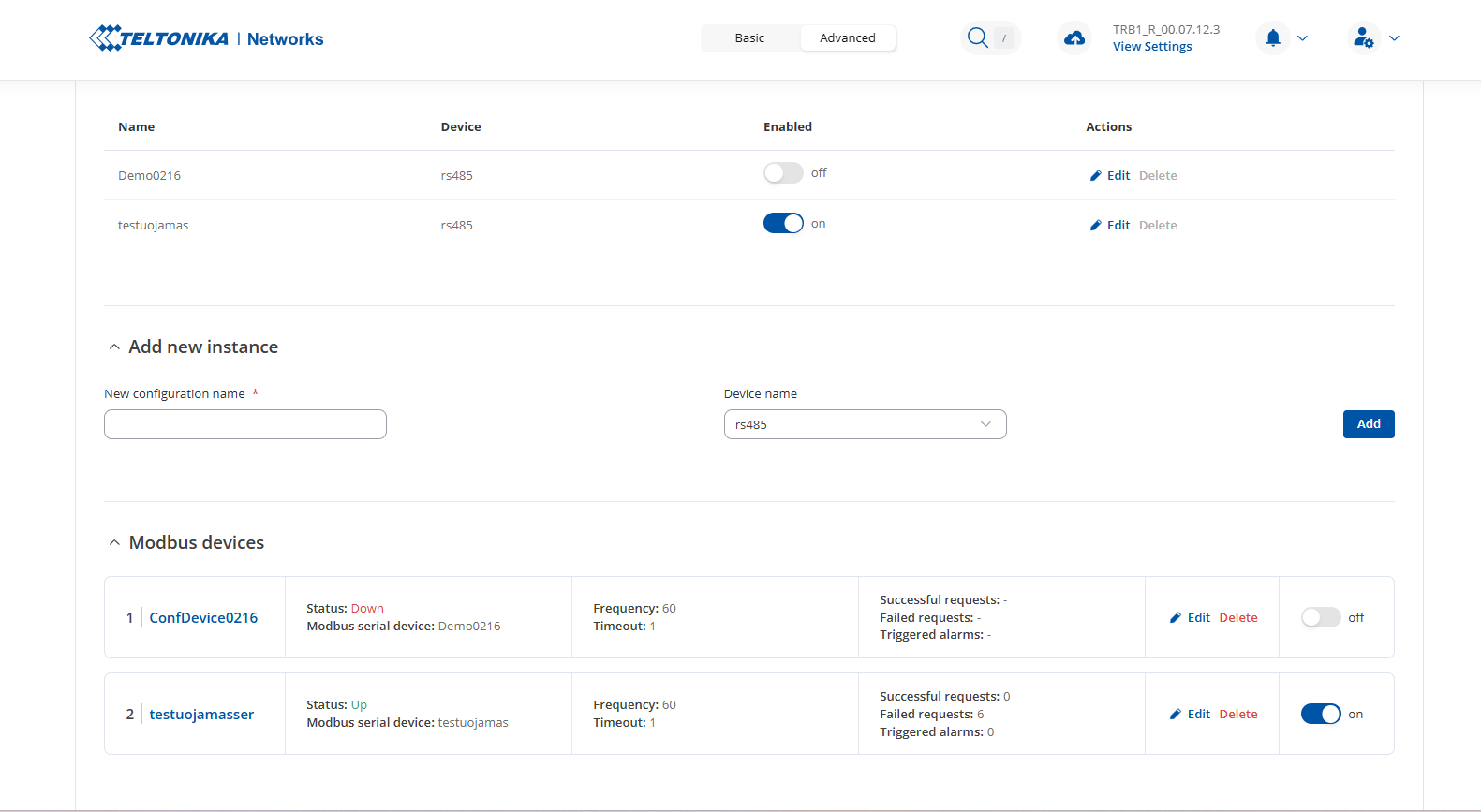

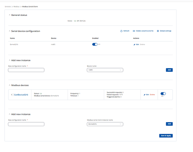

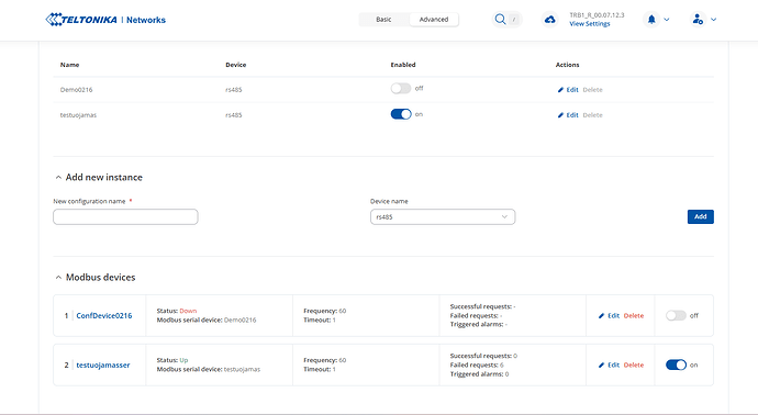

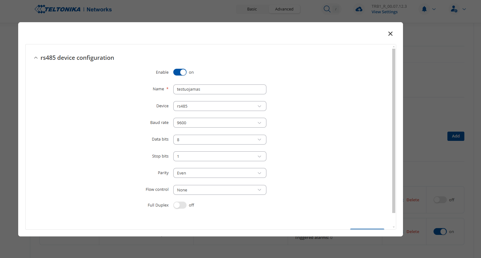

I have performed the requested tests and attached screenshots for reference.
I connected the device directly and used ModRSsim for Modbus serial communication testing. Despite the correct configuration, the result remains the same – communication error is displayed during the test.
Additionally, I have also tried adjusting the Period value to 60 and increasing it beyond the timeout (10, 15, and 30), but unfortunately, this did not resolve the issue.
Please let me know if there are any further troubleshooting steps you would recommend.

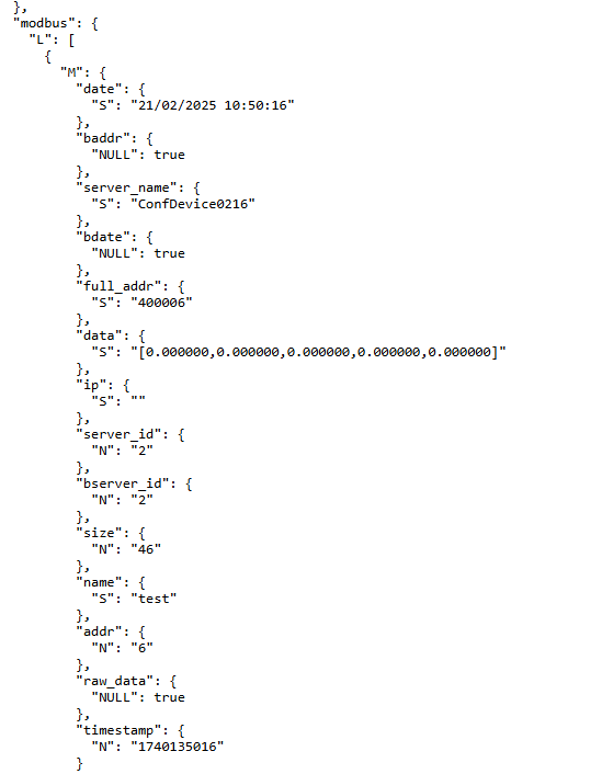

Thank you for your recommendation! Shorting the RS485 connections resolved the communication issue, and I am now receiving data.
However, the received values are all 0,000000, despite the fact that the meter is actively measuring. The same 0,00000 values are also displayed on AWS, but I believe this is likely related to configuration or data representation settings, which I will investigate further.
