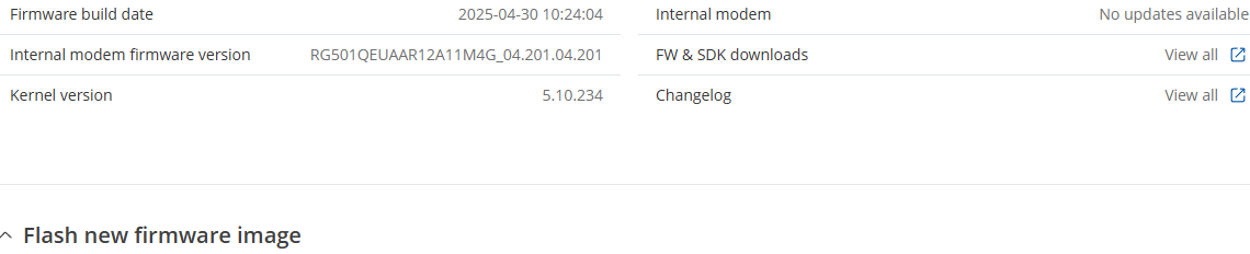

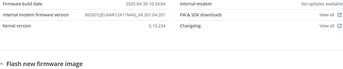

Could you please navigate to System → Firmware → Update Firmware in the WebUI and let me know the internal modem firmware version currently installed on your device?
i just took a working “3 network” sim out of slot and placed in the EE sim and still isn’t being recognised like before.
Thank you for the screenshot. I have sent you a form to fill out. Once completed, I will contact you privately regarding this issue. For the ticket ID, please use “14094”.
