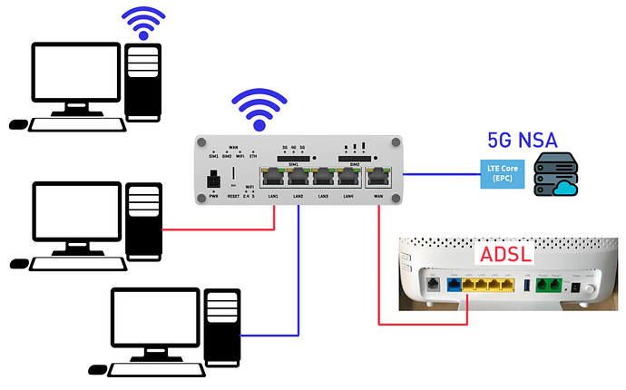

For certain applications like online gaming the 5G connection is not optimal so I have considered trying to add a DSL connection to the same device from another ISP (since fiber is not available where I live). And then serve either connection type to clients through the RUTX50.
And yes it would mean paying for 2 ISP plans for a while which is kind of dumb I know. I will have to see how things go next year, if e.g. 5G SA becomes available, assuming that helps at all or just switch to DSL only if that was possible and suitable etc…
I have created a rough (sorry :rofl:) picture of the idea, where e.g. the DSL connection would be served LAN (ADSL box) to WAN (RUTX50) or I assume that’s how it should work and then served over RUTX50 LAN port to e.g. a PC client.
Then the 5G NSA connection would be served over LAN/WiFi as it currently is.
I am not an expert on networking setups and in particular how such a concept could be achieved using the RUTX50 software so I would appreciate it if someone could outline the possible steps to achieve this if such a setup would be possible.

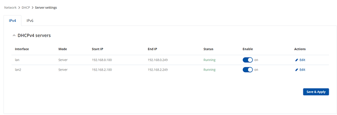

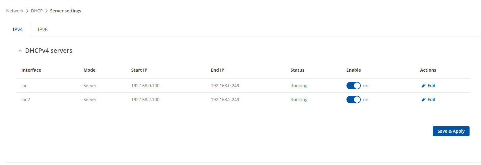

Thanks! I read through it and was able to follow the logic of the replies but it’s not clear. Based on the linked post there it would seem that for the RUTX50 that routing rules would be the best option.
I get the point of assigning DHCP ranges to each connection type but where and how exactly do you accomplish that?
My starting point would be these sections of the admin tools I guess.
/network/wan → wan
/network/wan → mob1s1a1
/network/routes/static_routes
This is where I set the DHCP ranges for each VLAN

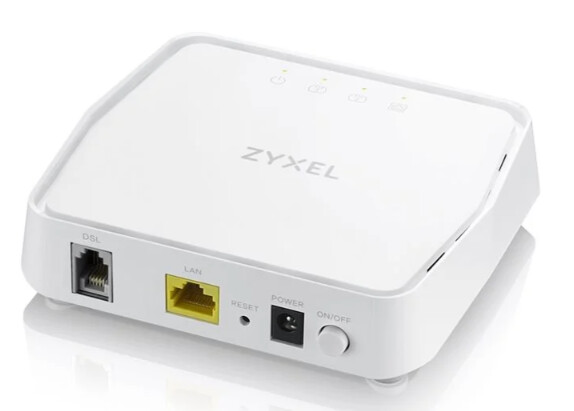

I was in contact with a local ISP to inquire about getting a VDSL connection. It would be like 100 mbps max (I think they cap it to guarantee the connection speed) and I would need to get a VDSL modem as well - I could I guess get a simpler model myself (that doesn’t have multiple LAN ports and WiFi) so that might work.
