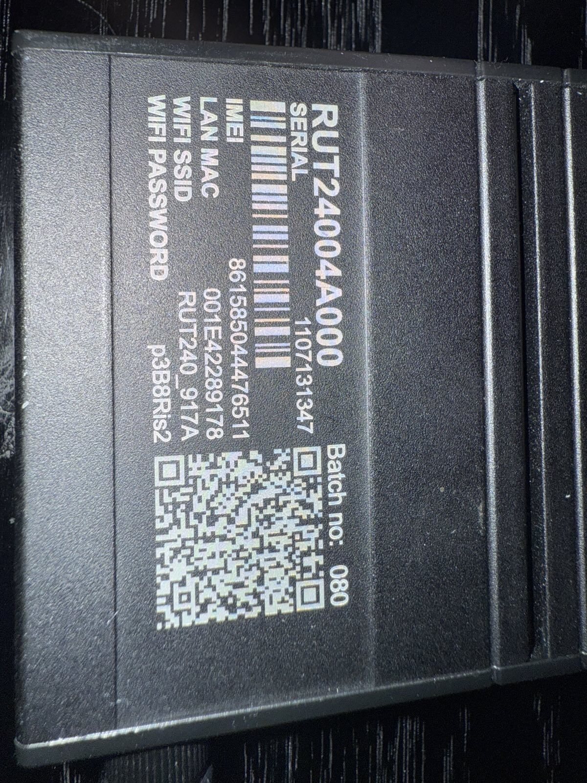

serial 1107131347
RUT24004A000
Batch 080
Please avoid sharing sensitive device information, such as the serial number, on public forums as it could be unsafe.

HERE IS ONE OF THE DEVICES THAT IS NOT WORKING
I can send all the units that are not working
Is there any assistance available
regards
Jeremy
Hello @jhamlyn,
Please avoid sharing sensitive device information such as the serial number, MAC address, and IMEI on public forums, as it may pose a security risk.
