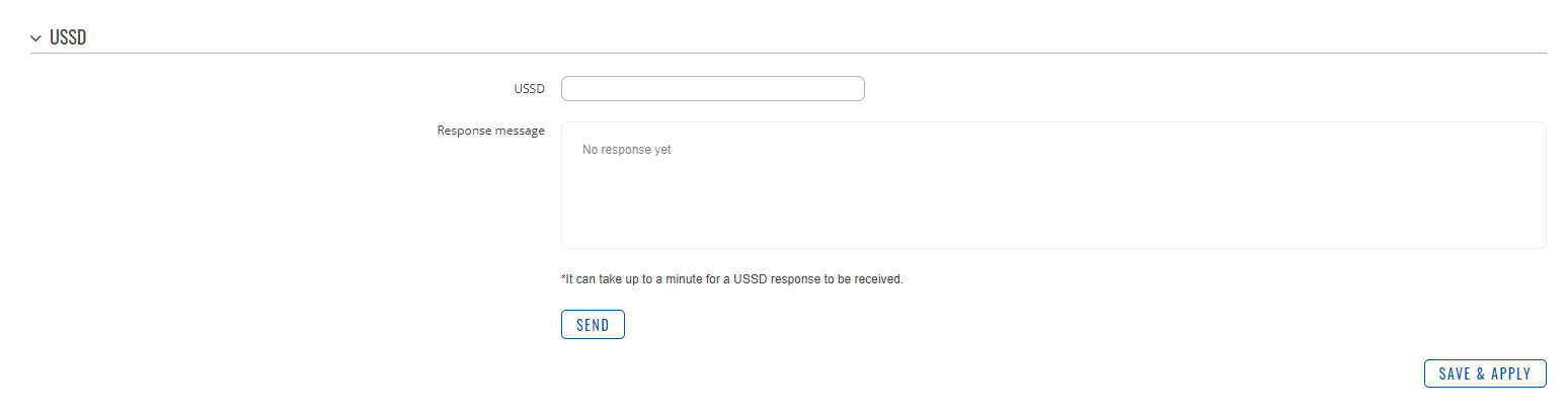

Have you tried to executing USSD commands in the WebUI itself. Seeing the image you attached, it seems like you were using the Legacy firmware, I cannot find the USSD section in the WebUI for the Legacy firmware.
But in the latest one 7.5 firmware, you use USSD in the NetworkMobile - > General, then scroll down in the USSD section.
I’m not quite sure if WebUI USSD is there in the legacy firmware, but if it’s possible, try updating to latest one then try executing the USSD via CLI or via WebUI.

In your case, try this command
gsmctl -U "*444*2#"
In my example ussd command, I need to type *101# then I need to press 1 two times.
So the format would be
*101*1*1#
