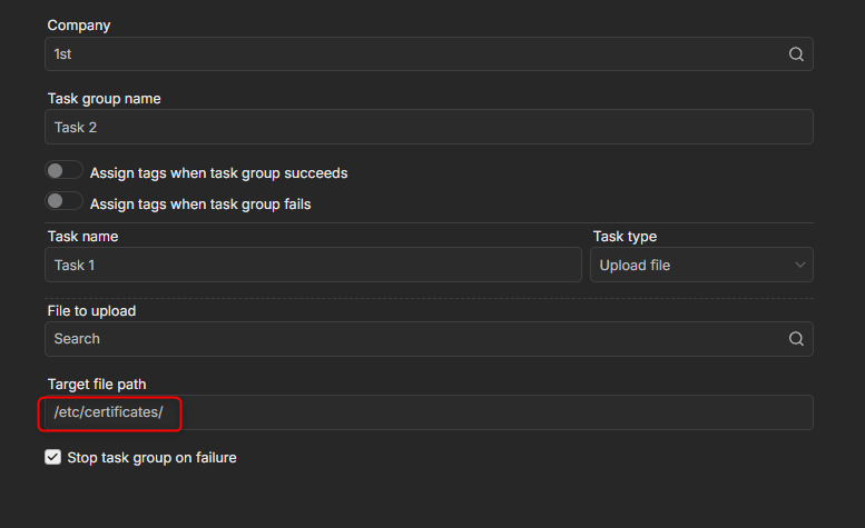

I want to push client certificates to several RUT241 devices using task manager in Teltonika RMS. I have setup a new task to upload the file from RMS files area by using /etc/vuci–upload/ in the target file path. I have a the task type set to ‘upload file’ and file to upload set to the correct client certificate in the files area. Upon executing this task for a RUT241 device I get a message to say an error occurred for task.

Hi Villus,
Thank you for your support there was a small typo of ‘upload’ rather than ‘uploads’ in the target file path for the first task. This has now executed the task successfully.

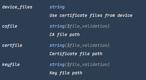

Thank you for your follow-up.

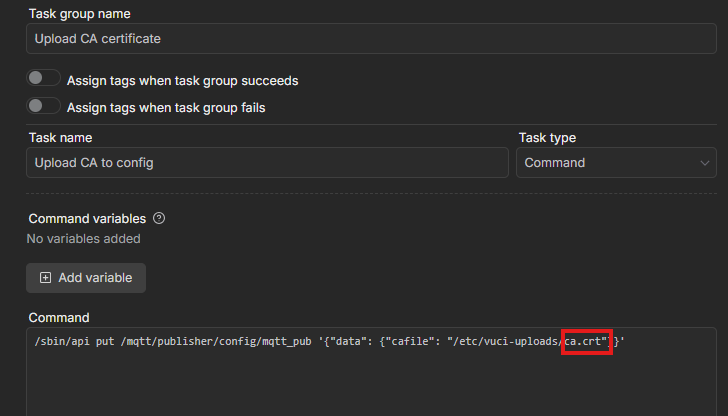

To make this work, you will need to adjust the command that pushes the file to the configuration. In the example provided, a file named “cafile” was used. While the file paths remain the same if you are uploading to the same directory, you must update the variable in the API call to match the specific file you want to apply to the configuration. Here is an example of how the variables should be set:

Hi Villus,
Thank you for the API link. I have been able to get that working, thanks again.

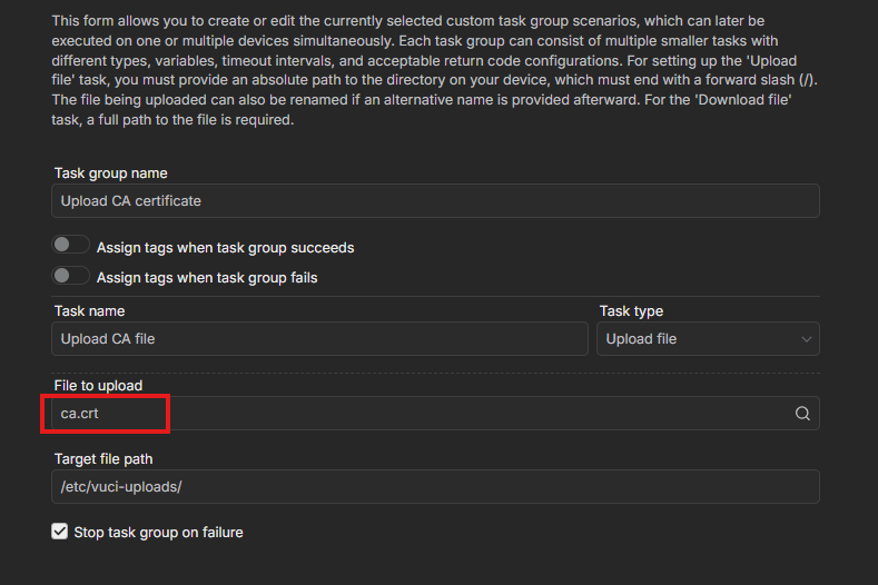

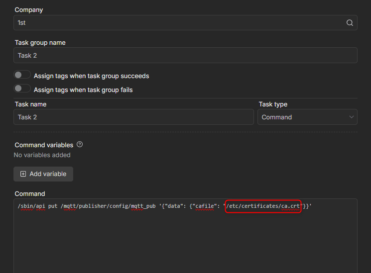

As discussed during our call, I am sharing the screenshots demonstrating how to adjust the task manager settings when working with a different directory. The first step is to update the directory path where the file will be uploaded, following the example below:
You will also need to adjust the command accordingly. Since the file location changes, the path inside the API call must match the new directory. In the example below, the highlighted section indicates the required “path_to_file/filename” structure:

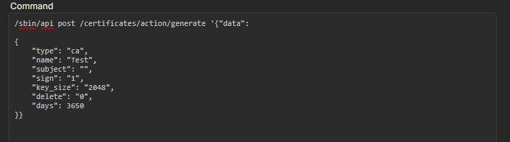

Regarding certificate generation, you should use the following API endpoint to review the available parameters and generate certificates:
For reference, your command should look similar to this:
This will generate the certificate in the same way as when using the device WebUI.

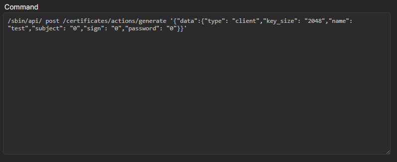

I want to test creating a very simple client certificate first. Please can you advice why this task command may not be executing successfully?
Kind Regards
Luke

Greetings, @Luke,
You can try adjusting the following API call to match the certificate file structure present on your device:
api POST /certificates/actions/generate "$(printf '{ "data": { "type": "client", "name": "%s", "subject": "", "sign": "1", "key_size": "2048", "ca": "ca_test.cert.pem", "ca_key": "ca_test.key.pem", "delete": "0", "days": 3650 } }' "$(mnf_info -s)")"
When testing this on my side, executing the above command successfully generated a unique client certificate, with the certificate name set to the device serial number.
Please let me know whether this API call works in your case or if you have any additional questions.
