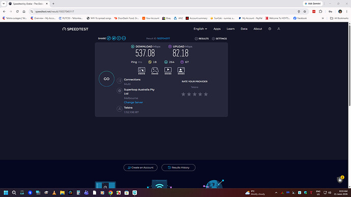

hi heartless i flashed latest firmware via bootloader and it seems to have worked. my speeds are back to normal on all devices
