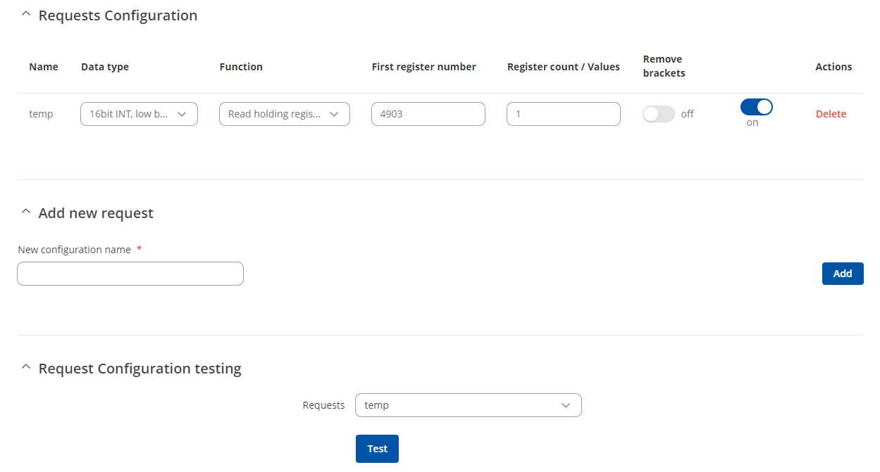

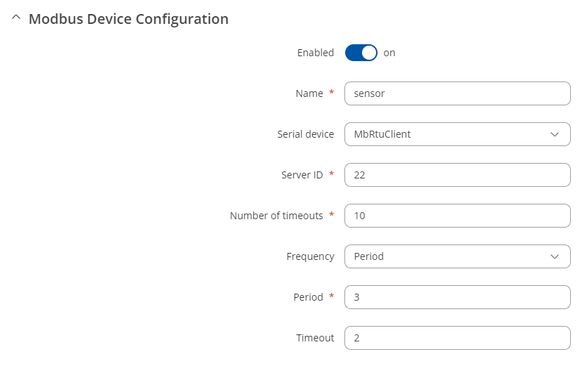

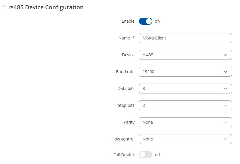

This is the configuration I have currently:
Modbus Device:

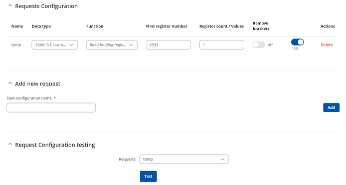

With registers
This is what I have tried so far
  • Modbus Serial Server
  • Modbus Serial Client
  • MQTT Modbus Gateway
  • Modbus TCP over Serial Gateway

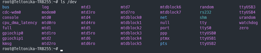

  • Running ls in the /dev folder returns no rs485 device. rs232 does show up.
Where do I go from here?
