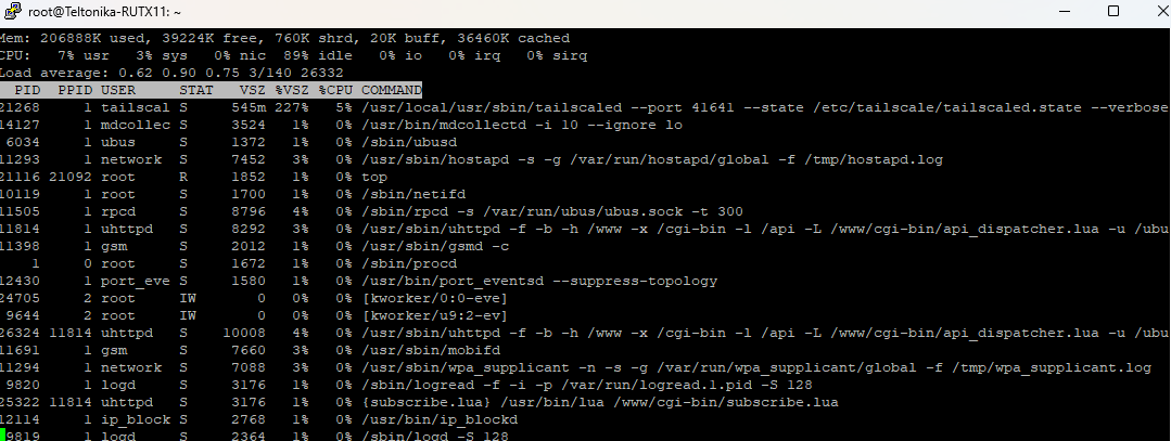

For several months now, I’ve noticed a substantial increase in RAM usage on my RUTX11 router, to the point that there are times when the device freezes and becomes unresponsive. I have hardly any services running; it’s all due to the Tailscale service.

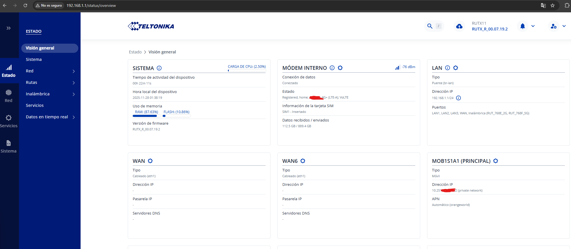

According to the router’s web interface monitor, its RAM usage is already around 80-85% after startup, and this gradually increases over time, approaching 100%. The resource monitor shows that Tailscale is consuming almost all of the virtual memory. If I disable it, the router works correctly again.
Today I tried to update from the stable version (.18.3) to the latest (.19.2), but the interface prevented me from doing so; there’s no RAM available. I had to temporarily disable the Tailscale service to be able to update and use the device stably.
