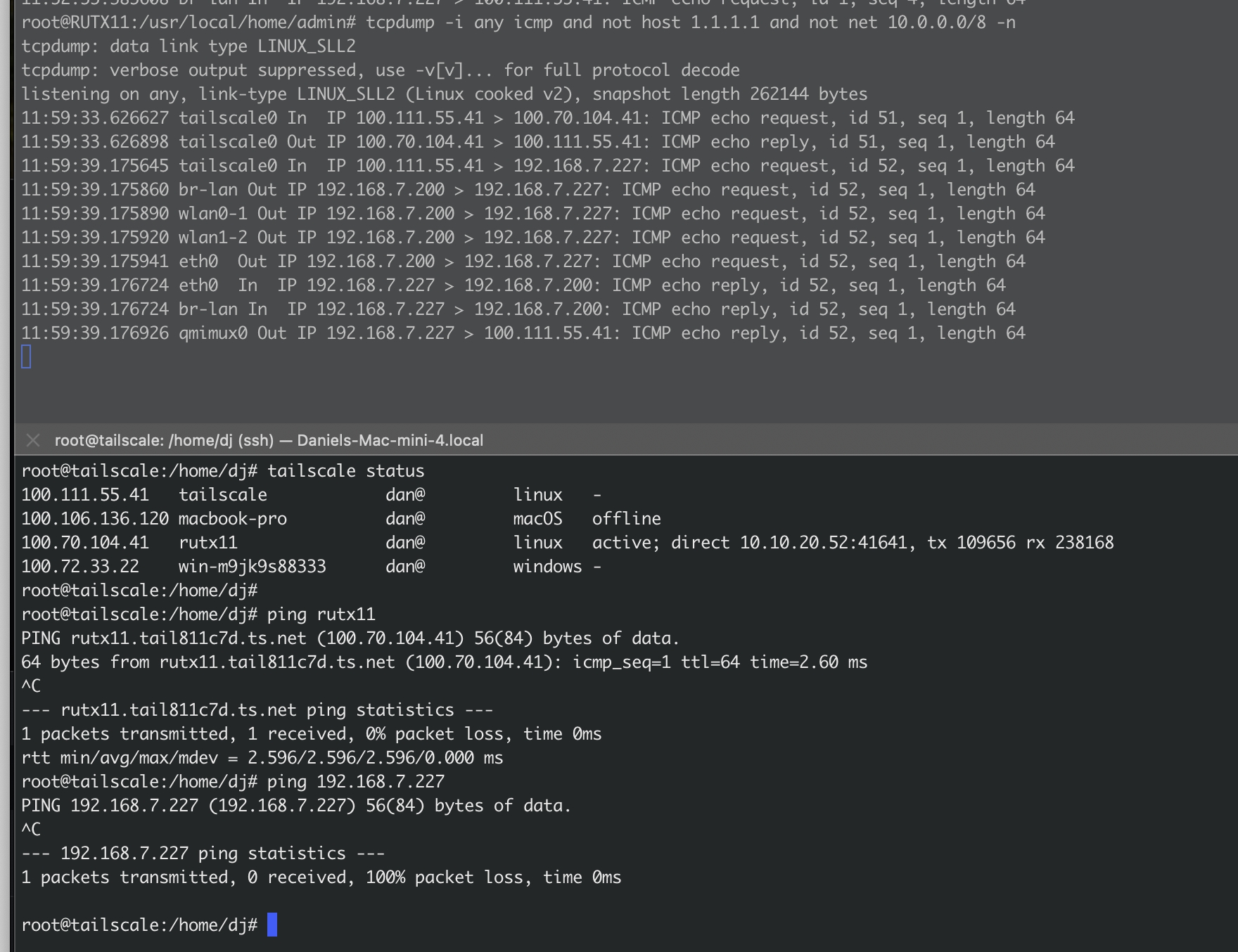

Im trying to get tailscale working but I see return traffic from hosts inside the RUTX11 LAN subnet trying to return traffic via qmimux0; rather than tailscale0.
I can’t find how to make it return traffic via tailscale0 to the source.
You can see that from gateway it returns via tailscale0; but traffic from the 192.168.7.0/24 subnet is returning traffic via qmimux0?

I found that once I disabled my mobile SIM connection; it started to work using the WAN interface. Im not sure I understand why as yet; as it should route over either connection.

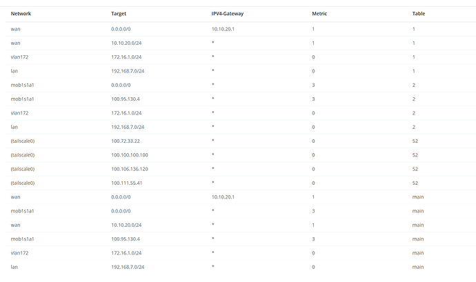

I have two internal networks, br-lan and vlan172. br-lan uses the 4G as the default route. and vlan172 uses the WAN as the default route. Both have failover profiles applied. I had openvpn working that allowed me to access the hosts on br-lan without an issue; but now testing with tailscale; my remote tailscale host can only see return traffic/icmp reply when pinging the br-lan gateway. If I disconnect the 4G ; then it works pinging hosts on the br-lan subnet. I though it was a conflict with my 4G sim having a 100.x.x.x IP address.. but this is just coincidence.

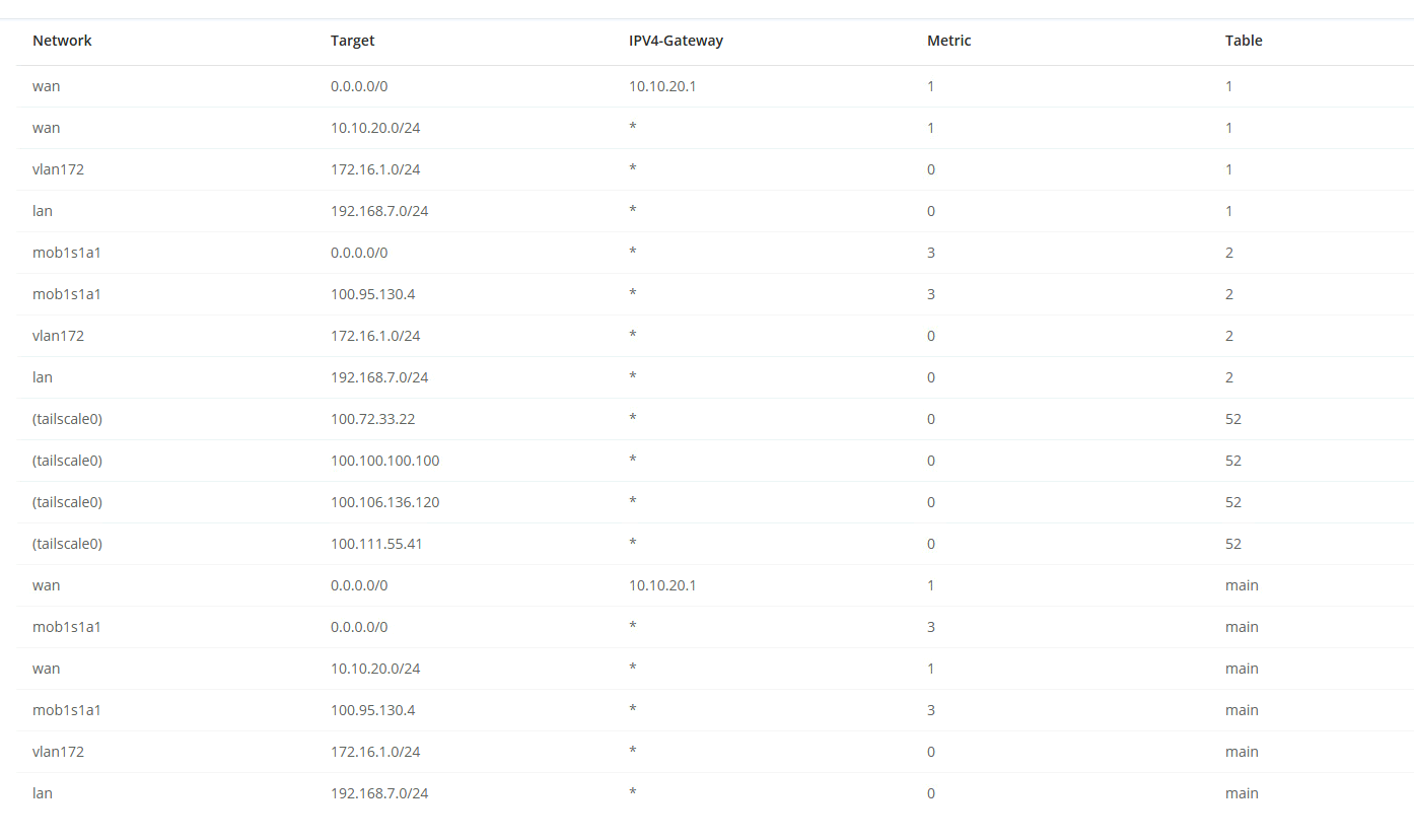

Tailscale creates a custom routing table 52 for tailscale routes. During mwan3 setup it deletes routes from custom routing tables if those routing tables aren’t associated with mwan3 interfaces.
As Martynas has mentioned, there will be a fix for this issue in RUTOS 7.17
