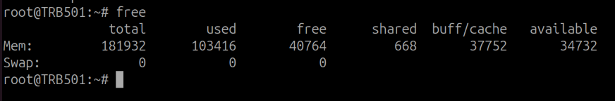

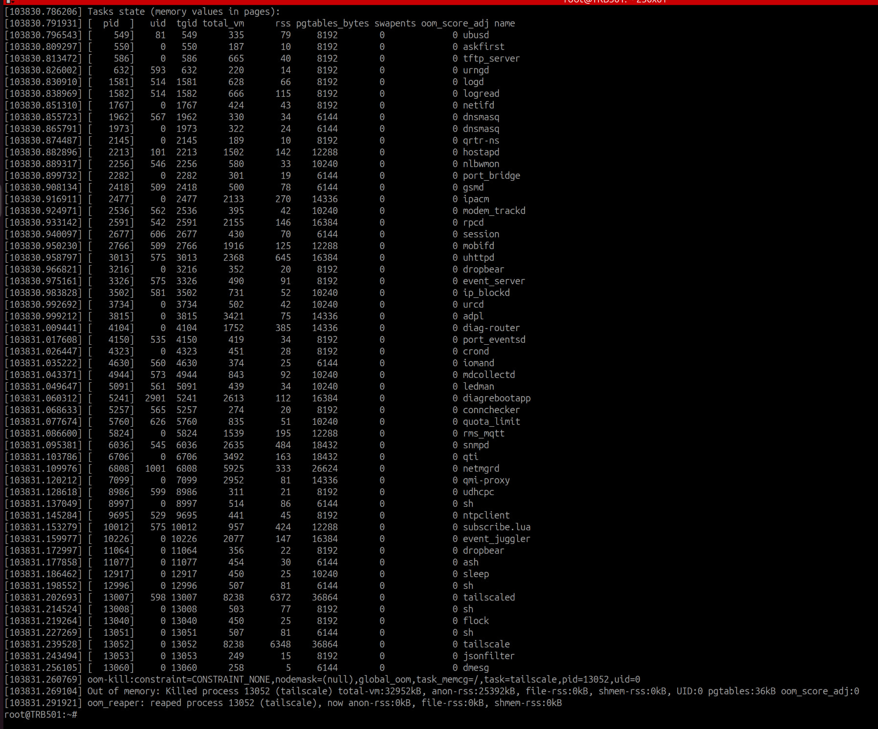

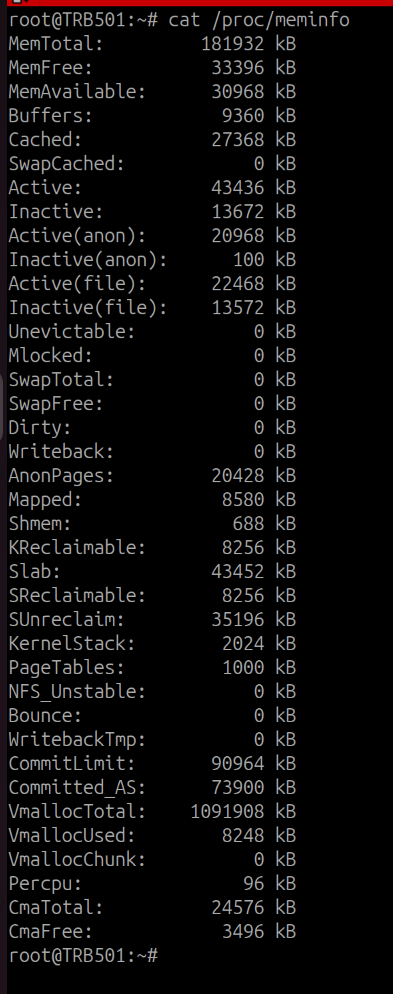

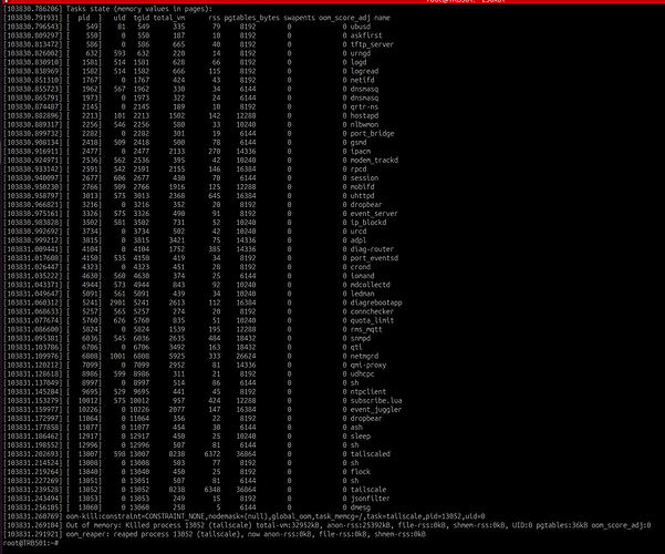

I’ve set up the 5G connection and installed the Tailscale package. However, as soon as I activate the Tailscale client, the system runs into an “Out of Memory” error.
This is a fresh, out-of-the-box setup—no additional packages or custom configurations have been installed.

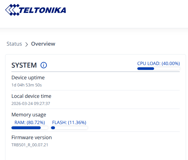

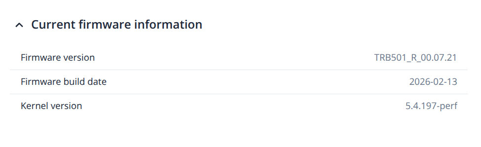

Teltonika firmware 07.22 has a new Tailscale package version. Maybe it will help. Though I am having issues getting the new version to start…
The error still persists on firmware 07.23.
Although, webui doesn’t crash anymore as it did on the previous version.
