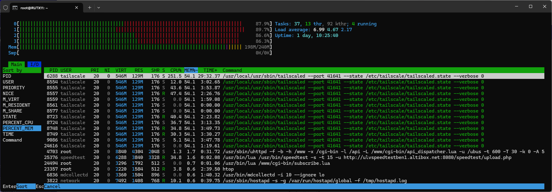

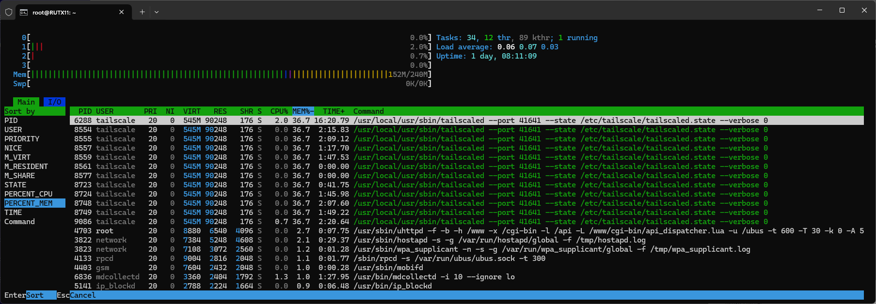

Hi, I am setting up my RUTX11, haven’t done much yet, but it runs out of memory just sitting still. No clients, just Tailscale. Have I done something wrong? Memory eventually peaks at 98+ % before it gets unresponsive.
After a bunch of speed test runs it peaks at 54.1 % Mem
All testing is done wired, and the results are abysmal: Down 25.76, Up 30.42 Mbps
My computer on the same switch gets Down 500.92, Up 492.61 Mbps, with Tailscale on the same exit node.
