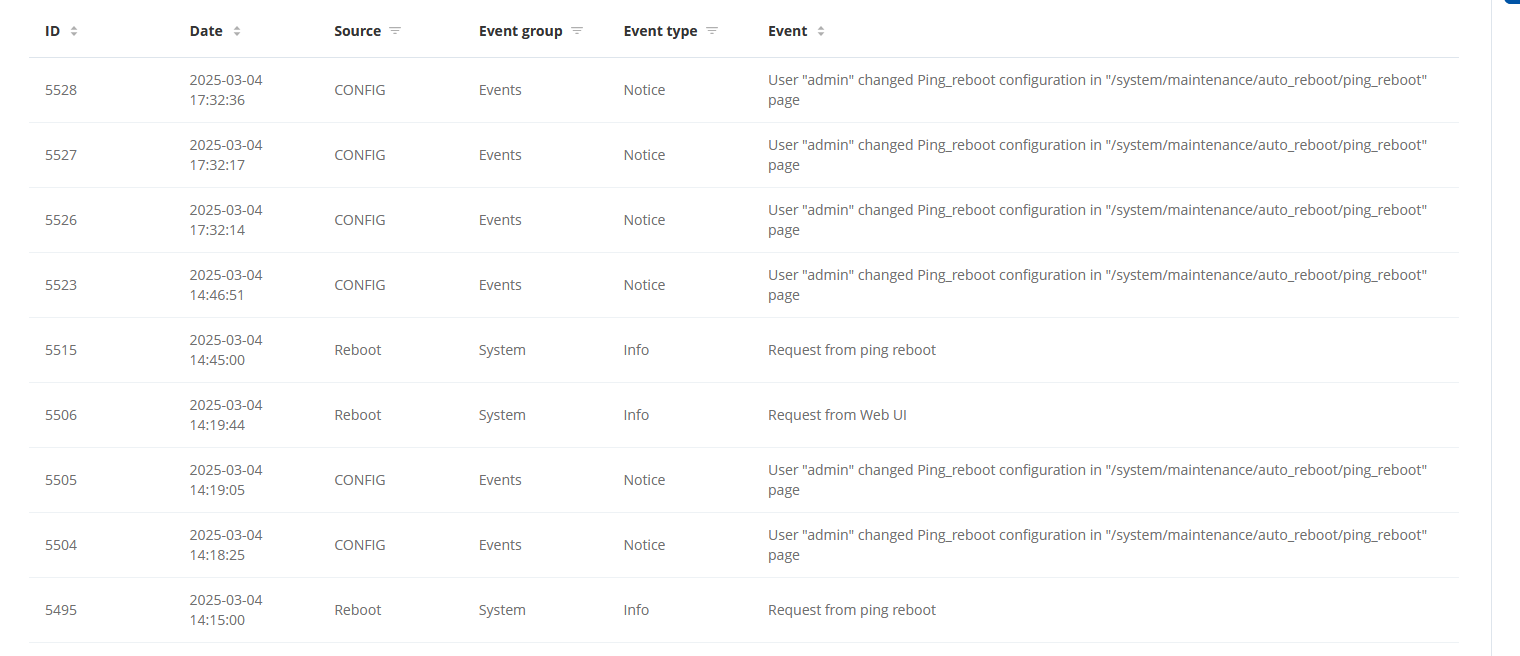

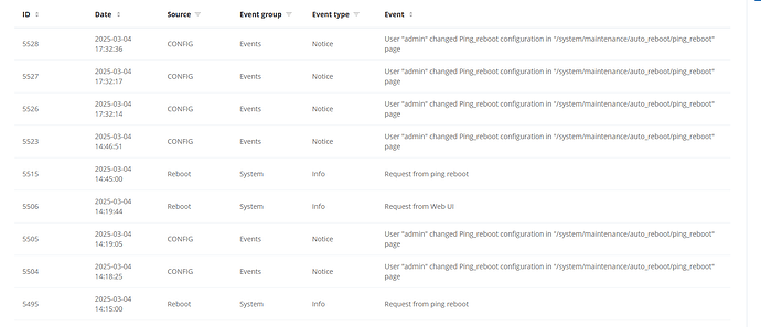

I upgraded to 7.13 and was getting ping watchdog reboots listed in the system logs. I fixed it by deleting the reboot action and recreating it. Editing the timing wasn’t enough to prevent the reboots.
The 14:15 reboot is exactly 20 minutes after the firmware update which aligns with two ping timeouts 10 minutes apart. I then changed some reboot interval settings and the 14:45 reboot was 25 minutes after the device booted. I turned the ping reboot feature off after this but then revisited it in the evening, deleted the old configuration and created it again. My device with 7.13 has been up for 23 hours now with the ping reboot feature enabled.
