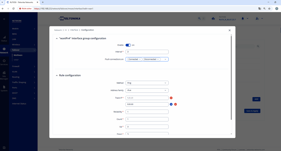

  1. Check MultiWAN configuration:

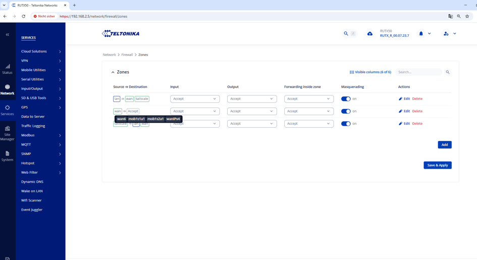

  • Is “Flush connections on failover” enabled?
  • Are both WAN interfaces assigned to correct firewall zones?

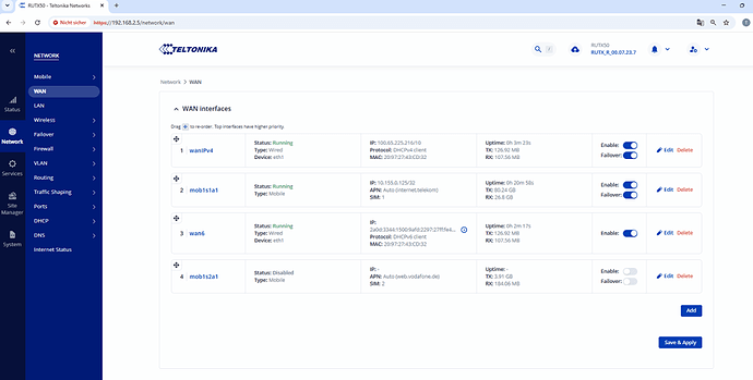

thank you for your response. To trigger the failover from WAN (Starlink Mini in bypass mode) to Mobile SIM (Telekom), I covered the Starlink antenna. Afterwards, I ran the test and received the following result:

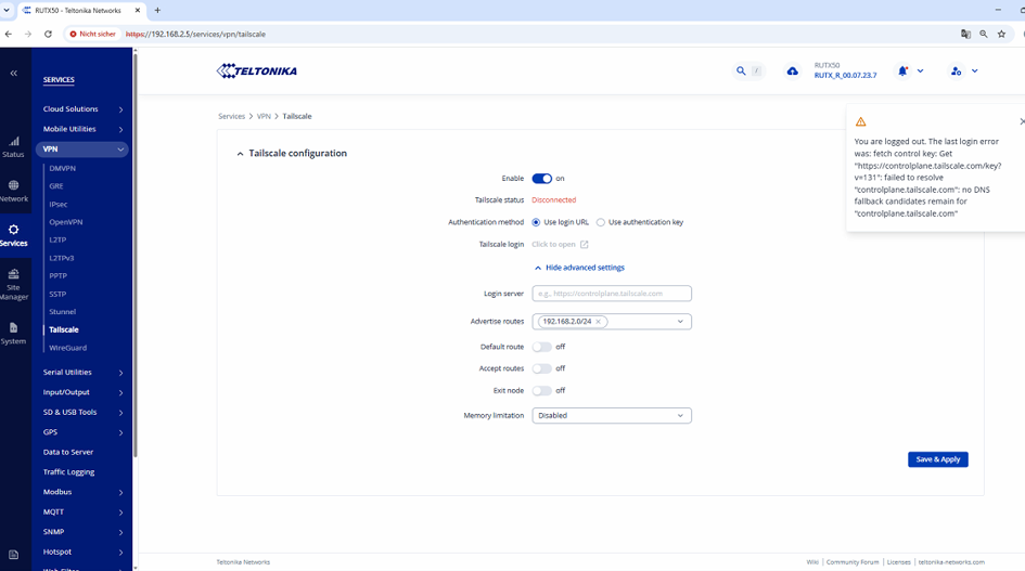

Afterwards, I restarted Tailscale on both my Windows laptop and on the Teltonika* according to your instructions. Unfortunately, the restart didn’t change anything. Tailscale remains offline on the Teltonika. The laptop was reconnected.
"root@RU T X 5 0 : ~# tailscale status
# Health check:
# - You are logged out. The last login error was: fetch control key: Get "https://controlplane.tailscale.com/key?v=131": context canceled
unexpected state: NoState

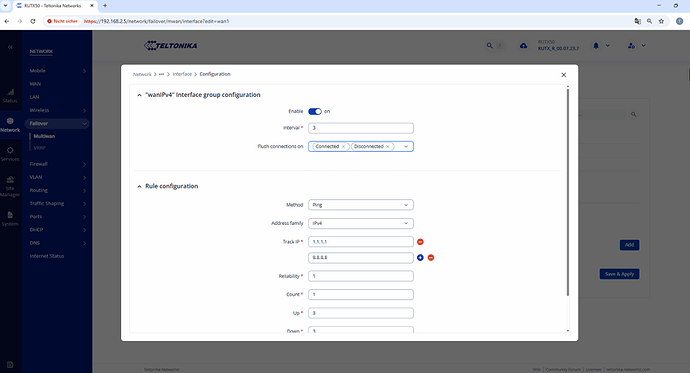

“Flush connections on failover” is active for WANIPv4.
Firewall settings are as follows:

I am using the latest firmware version (please see screenshot attached).
