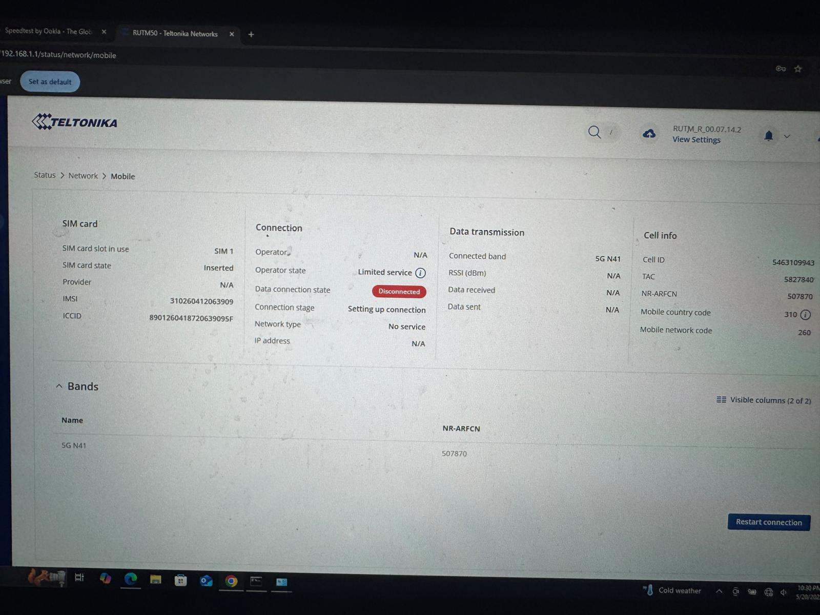

Additionally, please provide a screenshot of the Status → Network → Mobile page from the WebUI.

i have seen rejection message like a pop up but couldnt find the log to review it in detail , please see attached page you have requested
Could you please confirm whether both mobile antennas are properly attached at a 90-degree angle? From the screenshot, it appears that the device is not receiving any signal.
Additionally, could you let me know if you have configured any custom settings for Mobile on your RUTM50?
yes they connected 90 degree angle , we also have T-mobile 5G router and we can get 350-380 mbps from the exact same spot ..when we insert the same simcard , we get some pop messages , it is hard to catch those pop messages but it says , “rejected” ..and no connection ..APN is custom and we try both FBB and fast.tmboile..no luck
