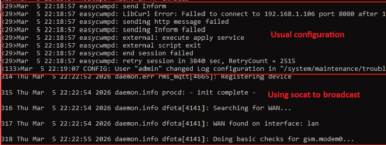

logread -f | socat - UDP4-DATAGRAM:255.255.255.255:5595,broadcast &
You may also use 192.168.13.255 as the broadcast address. However, 255.255.255.255 can be more flexible if the device is deployed with a different subnet.
Please note that the output format of logread differs slightly from the format used when logs are sent when configured via the Logging Settings in the WebUI.

Yes, this works!
