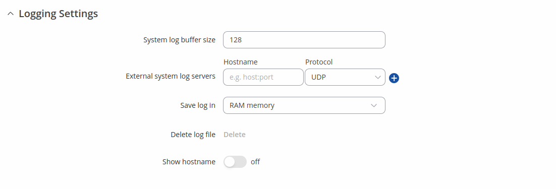

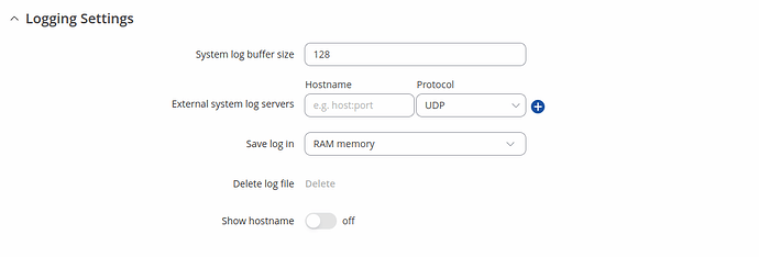

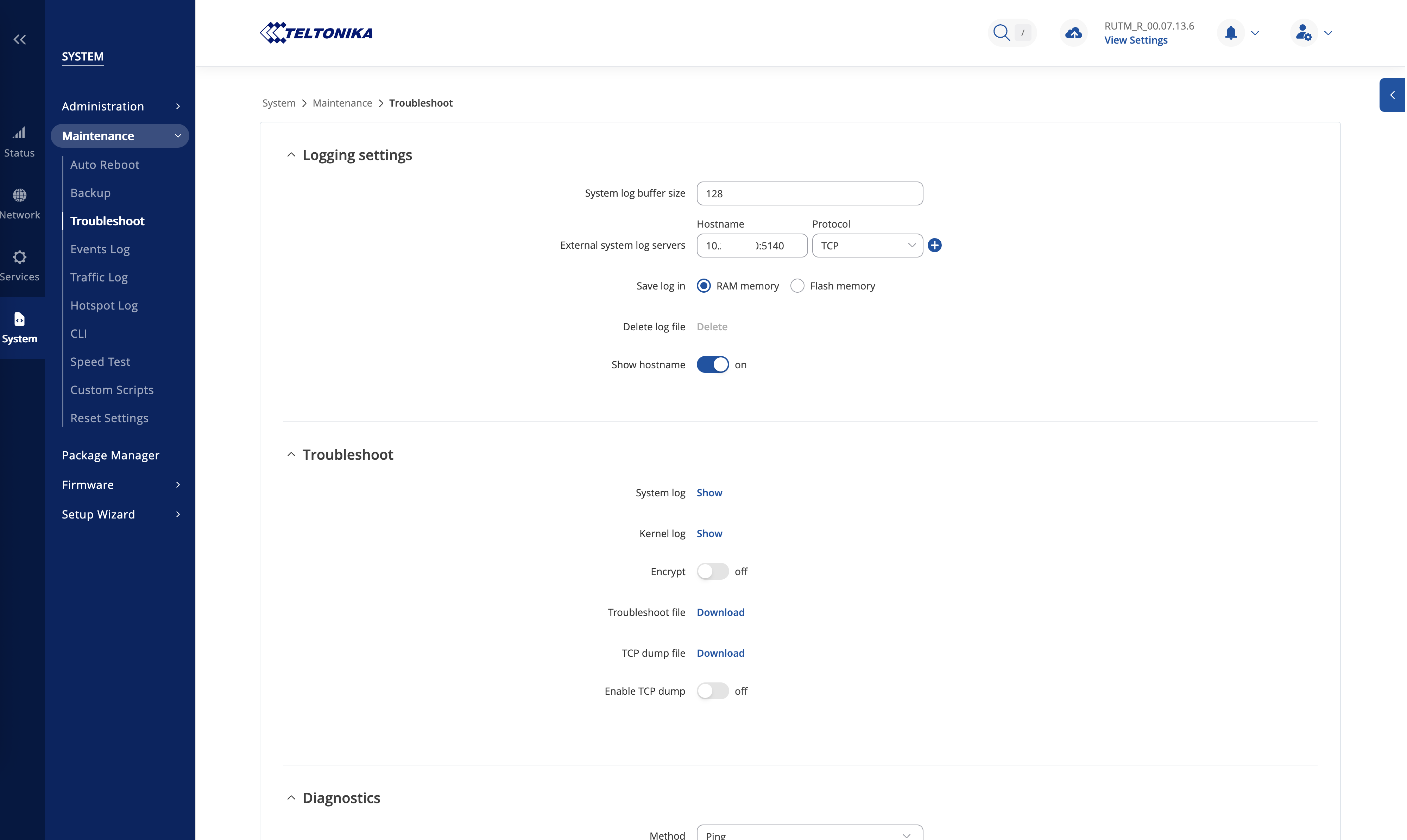

For logging actually to work in the first place, you need to set up the Logging settings found under System → Maintenance → Troubleshoot → Logging settings:
After configuring & saving these settings, logs should start being pushed to your server.

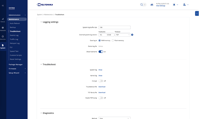

OK. I have the logging settings enabled with syslog. But seems I am not getting all the logs I would expect. Like traffic logs, etc.

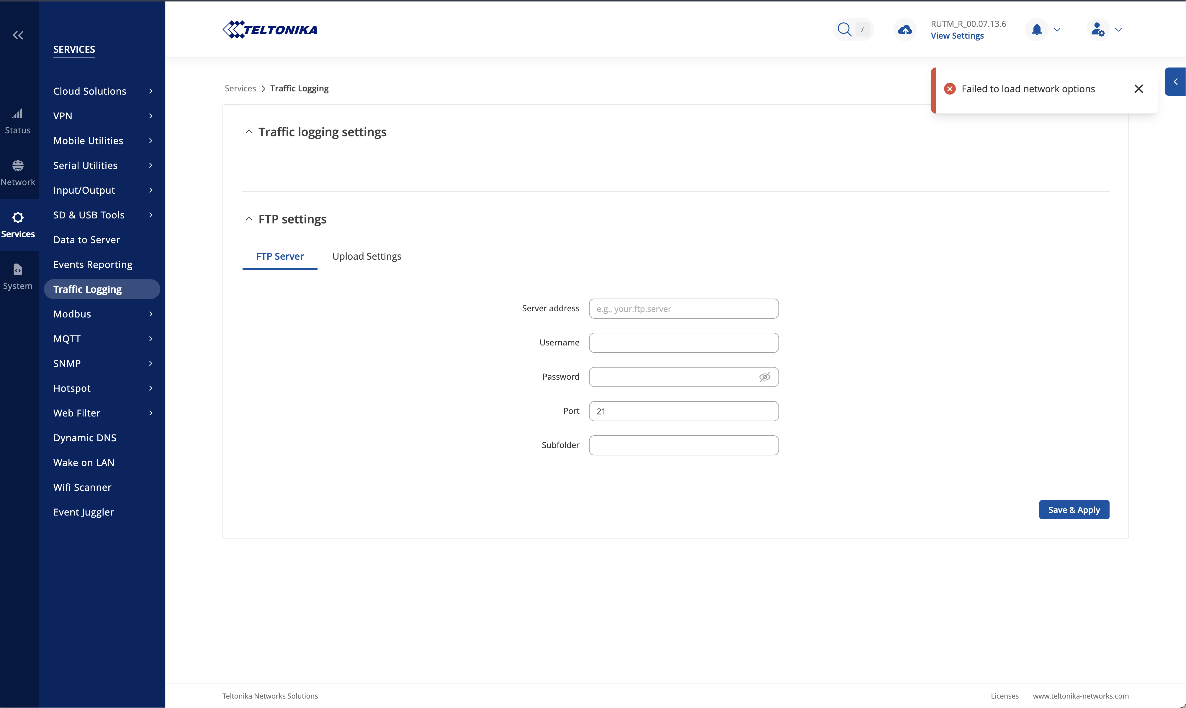

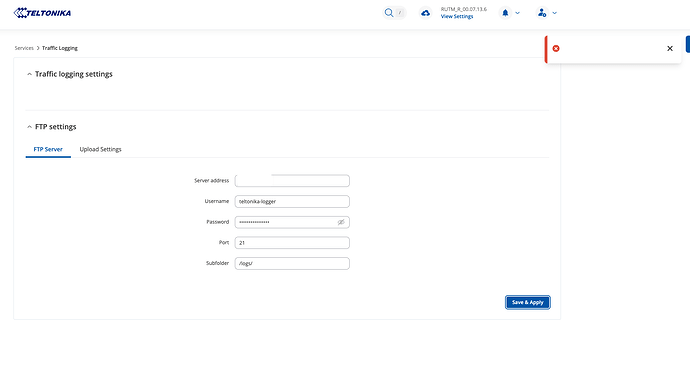

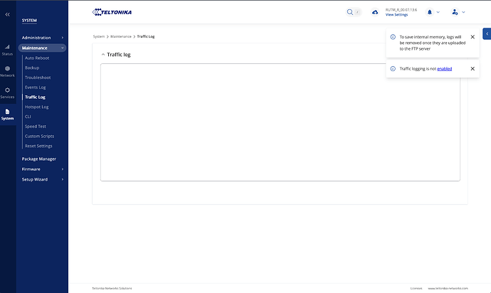

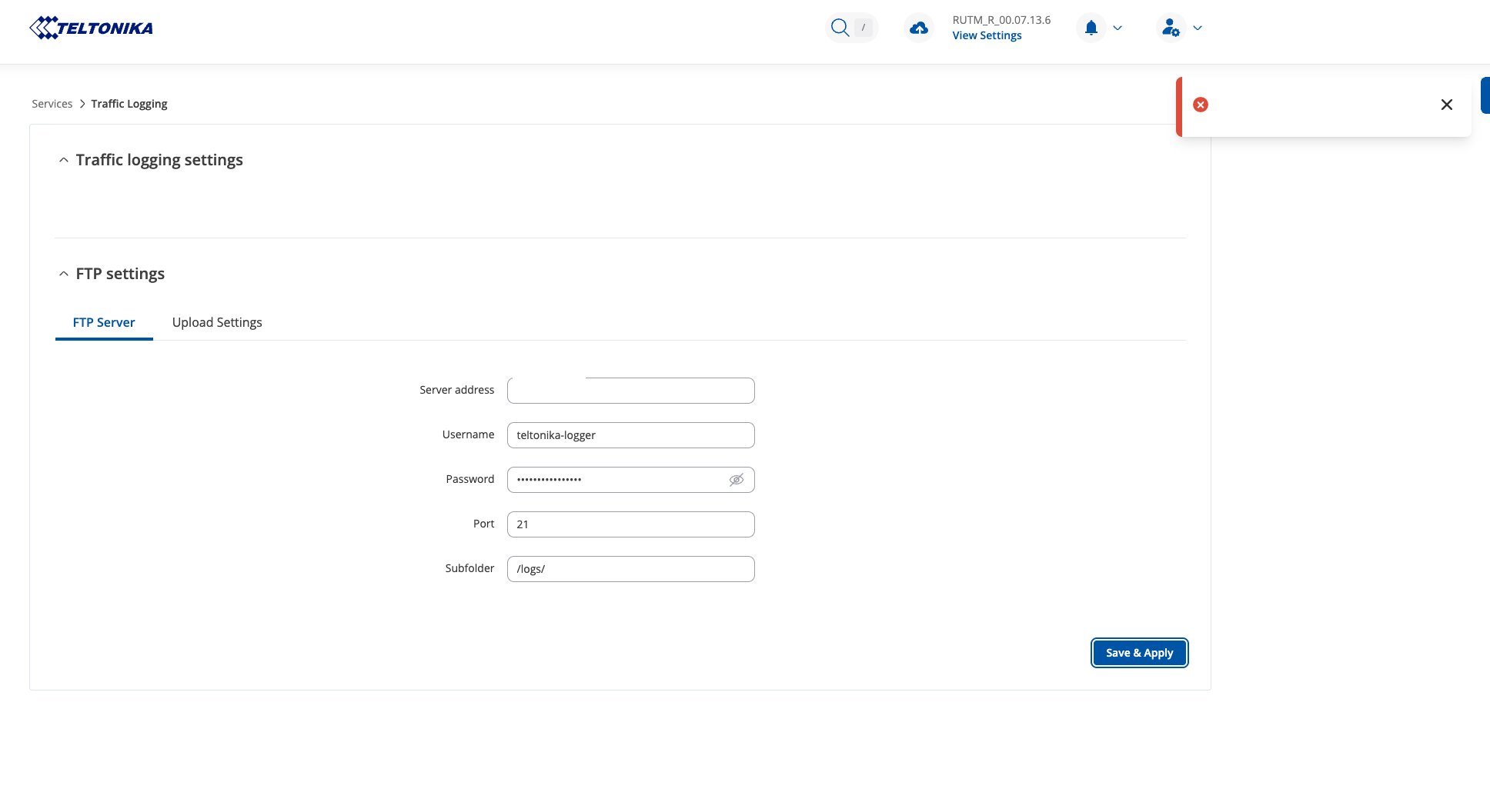

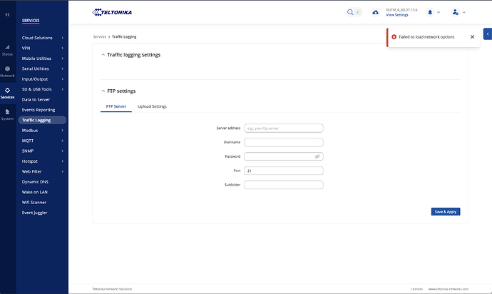

When trying to enable FTP for Traffic Logging, I get an error that does not say anything…weird…

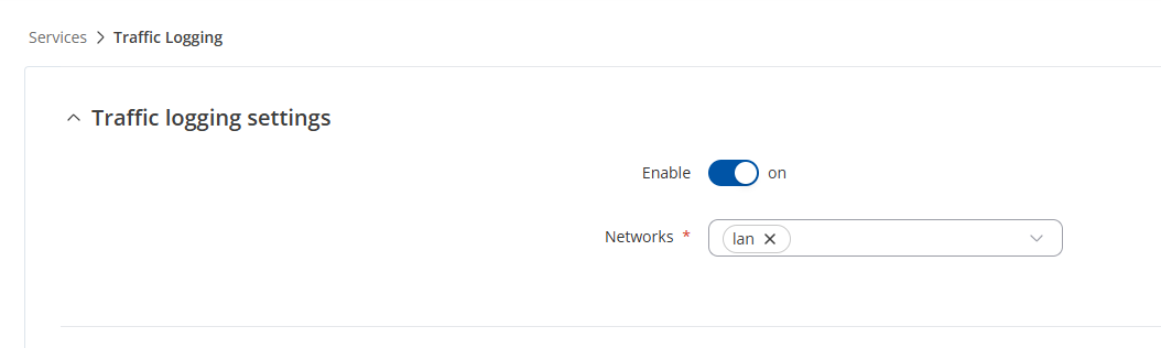

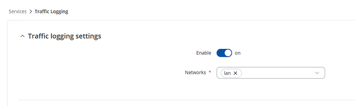

Thanks for providing the screenshots. I’ve tested configuring these settings on my own RUTM51 and had no issues at all. Looking at your screenshot, however, I can see that you are missing the “Traffic logging settings”, which, in your case, are blank for some reason.
I would suggest trying to reset the device via the Bootloader menu to see if they re-appear. They should look like this:
