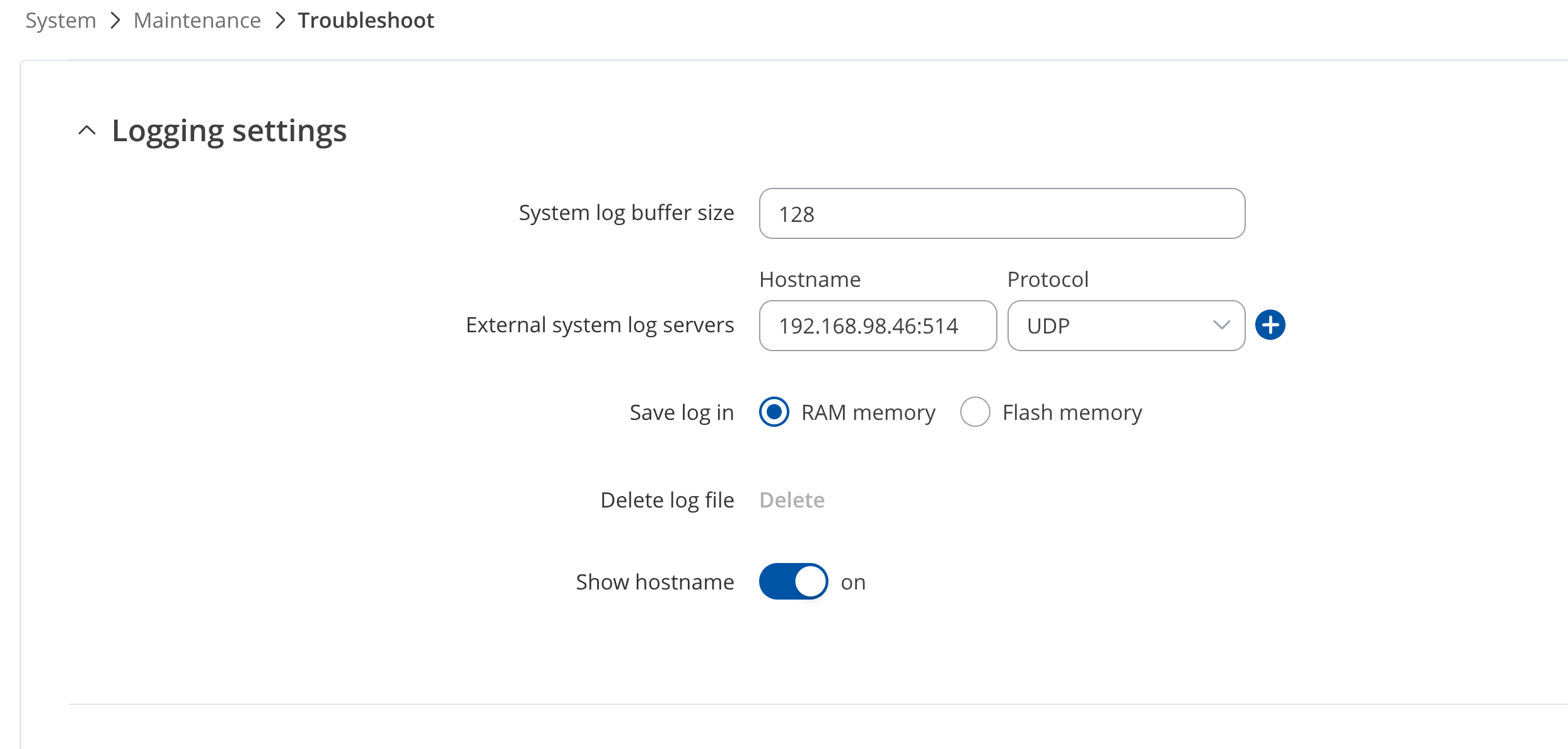

From the UI go to System->Maintenance->Troubleshoot->Logging settings and set the values to fit your needs. See the example below:
Ok. Yes. But what logs are sent? Doesn’t seem like firewall logs are sent using this setting?
All logs are sent. Firewall logs are not enabled by default change the setting via Network->Firewall->Zones edit the zone and go to the advanced settings tab.

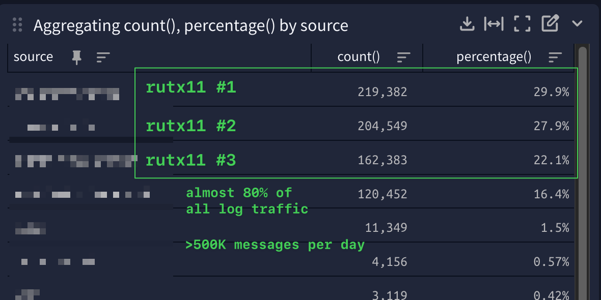

The logs are very verbose. I’ve got 3 units shipping logs to a Graylog server and together they account for 80% of the daily message volume, over 500,000 messages per day. Every DNS query is logged, for example.
I checked the command that’s used to ship the log, and it’s just /sbin/logread -f -r your.log.server 514 -p /var/run/logread.2.pid -u -h your-device-hostname
Checking the help, it seems like some GUI knobs to control the -z or -Z options could help cut down on the verbosity. Would be nice to see this…
