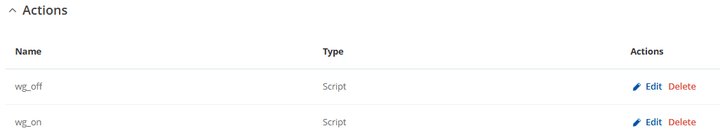

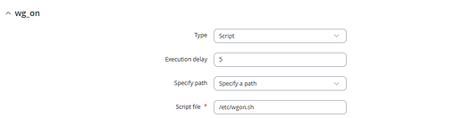

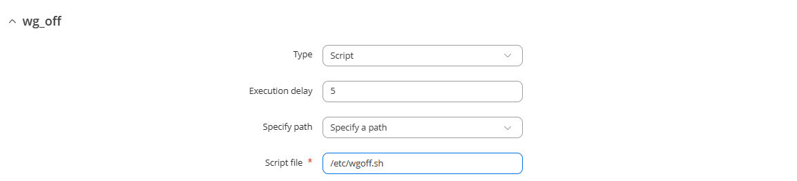

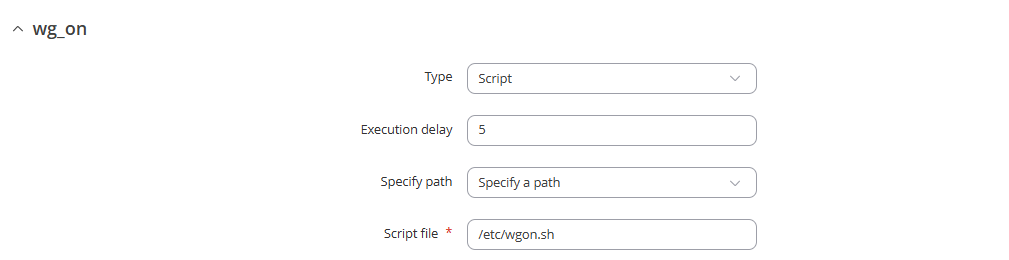

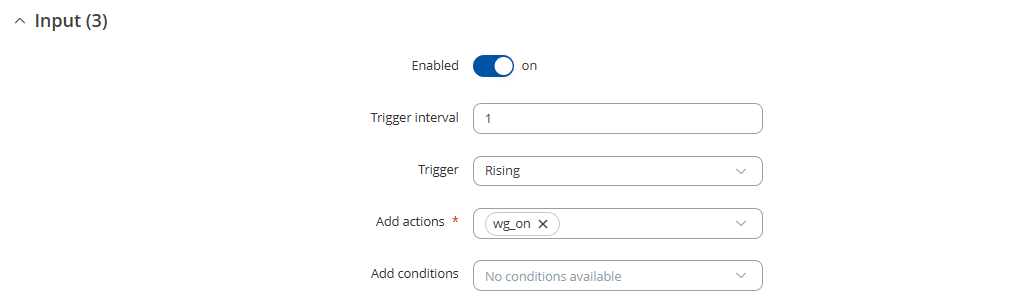

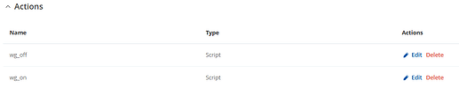

  3. Create Actions

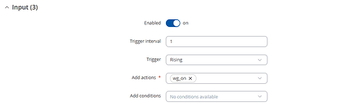

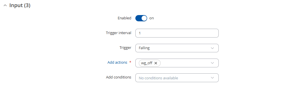

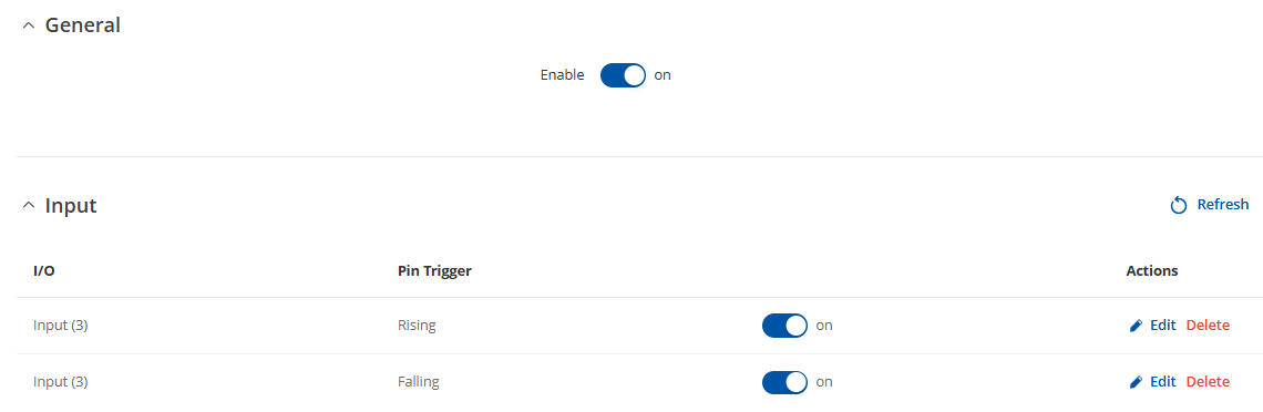

  1. Set Up Triggers
  1. Save and Apply Changes
    Click Save & Apply to finalize the configuration.
