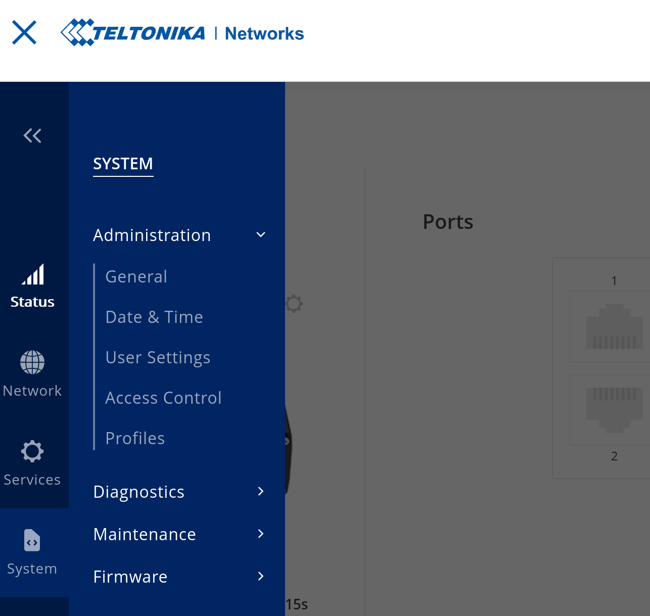

In the TRB140 my Web GUI certificate expired and I was able to replace it via the Certificates section, but the switch does not seem to have any such page.
What happens after the default HTTPS certificate expires? Are you planning to add this section there as well?

Hi. Okay but is there a way to change the Web UI certificate at all, for example somehow via SSH? Because in a few years the certificate will expire, and unless a new certificate is automatically generated and put in place (which I don’t think is the case, since on the TRB140 I had to change it myself) then it will stay expired.
Which won’t affect the functionality of the switch as you say, but will look kind of odd at least. Imagine a scenario where these devices would be installed for a customer and in a year or two they would discover that their browser shows a certificate error on the login page.
