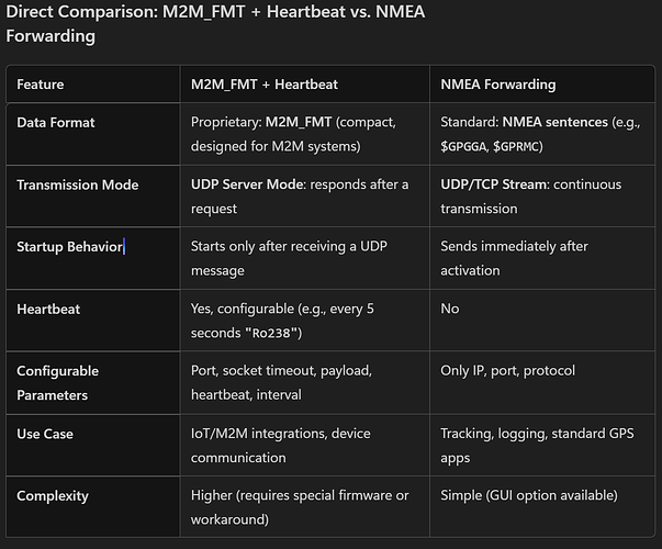

We are currently testing the RUTX50, hoping to get it running smoothly. Our existing 4G router uses the M2M_FMT format, and behind it is a Finnish application that prefers not to change its setup. This is why we are asking these questions—because it seems that some Teltonika devices support this approach and file format. Otherwise, we will need to look for an alternative model or even a different brand.
See here the differences:
Thank you in advance for feedback.
Iwan
