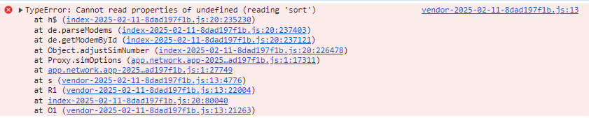

The Status Overview page show me a popup alert: “Loading overview data is taking longer than expected”.
The Wan interface is stuck in a loop on this call:
I think that your RUT241 /etc/board.json file got corrupted during installation. Probably best just try to install it again with keep settings off. Or if you want to recover without flashing new fw you can try executing few commands via cli:
