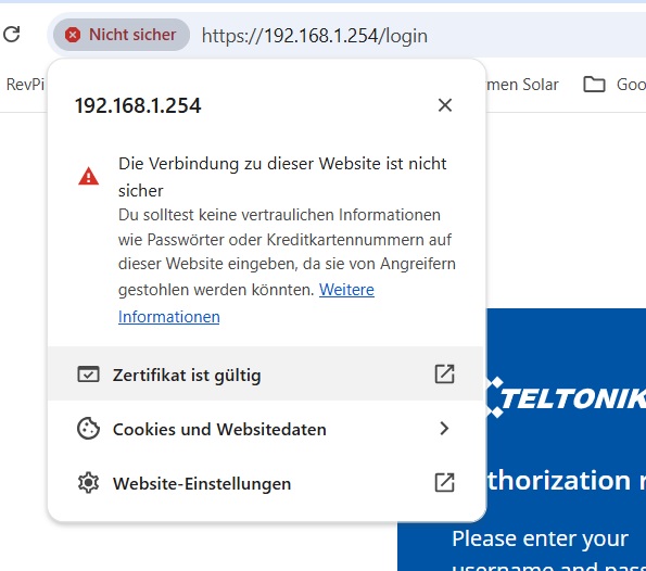

I used your guidline:
But I still get on the Chrome “not seccure” but “valid”.
Do you please have some hints or did I do something wrong?

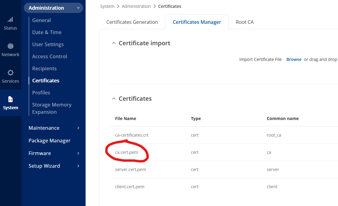

Assuming you used the ‘Simple’ method to generate the device certificates …
Did you download the ‘ca.cert.pem’ and install it your computer? You’ll also need to restart your browser, for the new certificate to take effect.

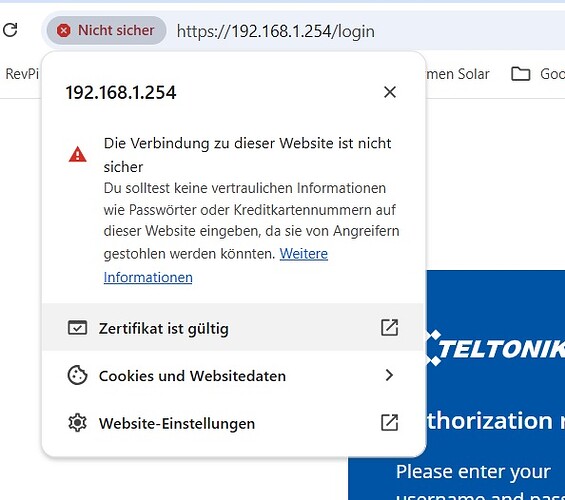

Yes I did already before.
It looks like it took some time.
Or:
I think it was maybe the restart of the browser, as I had several chrome windows open.
I think it worked after I closed all chrome windows.
Now chrome displays it correct.
The issue with password I wrote before was my fault.
Chrome stored a different one as I have several RUTs.
