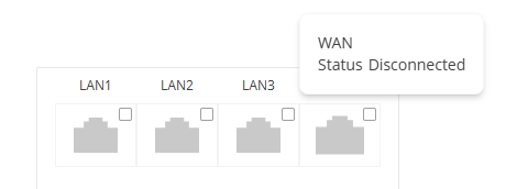

Does connecting a different device to the WAN port of the RUT240 work as intended? More so, when connecting the Starlink, if you go to the RUT240 WebUI → Network → Ports section, are you able to see whether the interface shows that anything is connected?
Additionally, when connecting the Starlink to the WAN port, do any LEDs light up on the RUT240 WAN port itself?
So inorder of question
No it dosnt seem to recognise any other connectios
Yes it shows as disconected in the UI and
No there is no a led when you plug in the starlink or other devices
Ive looke throu the UI and there seems to be no way of turning the port off equally if it is set as a 2nd LAN it does nbot connect to my laptop
