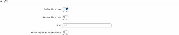

Hi, I cannot connect to my router RUT955 via SSH, I always get a “connection refused” error.
I tried with my phone and with a windows pc in the command line and also with Putty. Always connected to the same WiFi network.
It should be easy…
SSH is enabled, port and IP are correct.
I also tried with “Remote SSH access” ON and OFF.
Firewall all set on “Accept” for the network used.
Can someone help me to troubleshoot this?
