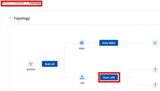

Alright, let’s confirm if your speakers are connected to the WiFi and have internet access. To do this, go to Status → Network → Topology and scan the LAN network. Check if your speakers’ IP address is listed.
