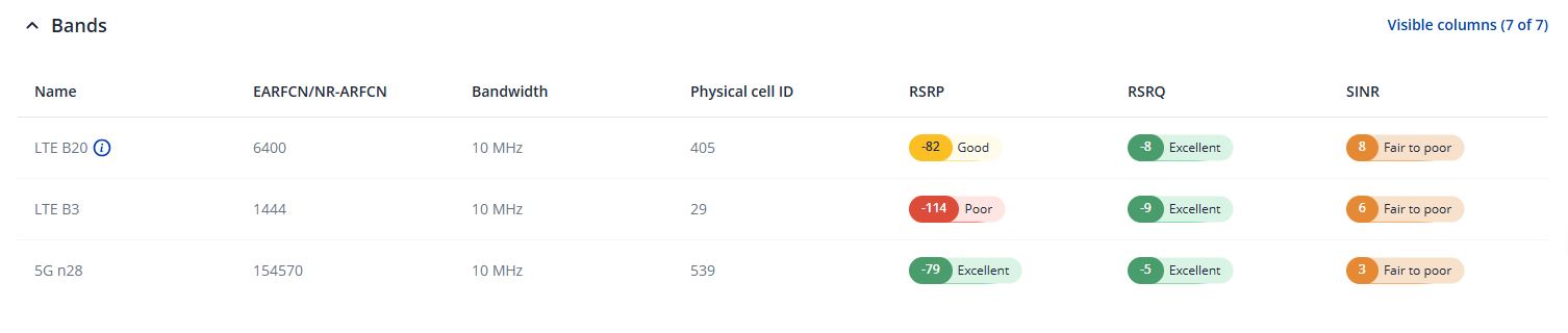

I have a 5G (RUTM51) connection, also with my mobile phone. On the phone, I measure 94 MBit, on the RUT only 27 MBit.
The 5G LED on the RUTM51 is always on. A modem update was performed, and I no longer have interruptions. Is the speed test in the RUTM51 menu reliable? Actually, I also don’t have any problems with video streaming.
Modern phones support faster LTE technologies and different modem architecture than most Teltonika-Networks devices as they are made and used for different purposes. Most of the speed discrepancies are due to carrier aggregation (CA). To see how CA and other factors can affect LTE speeds, please refer to the LTE Speed Discrepancies page.
