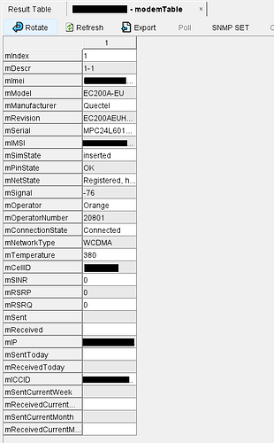

We have a new RUT200 and I see how can i enable the SNMP V3. It works good for multiple SNMP info but I want to have the “mSentCurrentMonth” and “mReceivedCurrentMonth” data and the equipment don’t respond for this. Why ?
Is it a problem with the firmware version ?
I have the RUT2M_R_00.07.14.2.

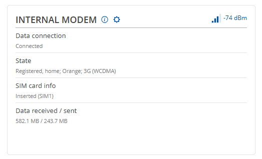

And in the Status overview page I have the Data received / sent, so I don’t understand :

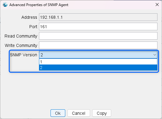

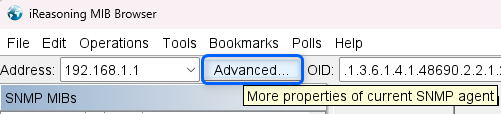

Open up your MIB browser, select Advanced:
Then ensure that your SNMP version is set to 2:

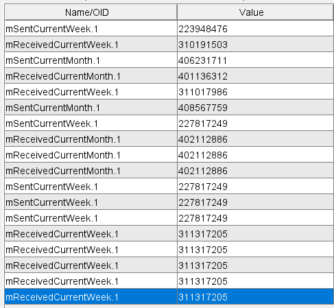

Right after, try to Get all the values again, for me, it started working right away:
Yes thank you, it’s strange but it works fine in v2c or v3.
