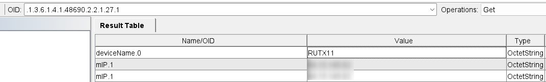

Tested with 7.20.1 on a RUTX11 - everything works just fine. Was able to get all the information, even the mobile IP address you’ve mentioned:

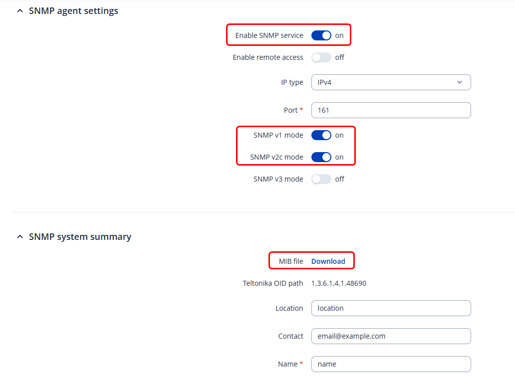

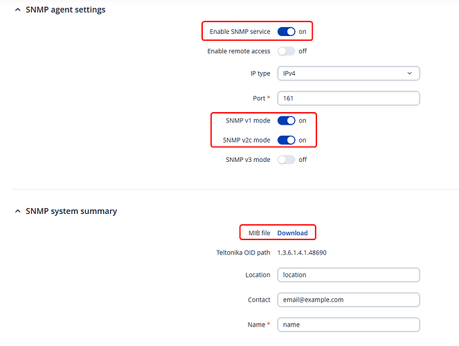

My settings are as follows:
I’ve downloaded the MIB file (outlined in red) and uploaded the file onto MIB Browser (an app I used for this test). Everything functioned properly.

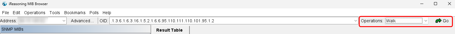

What app are you testing with? Is there any other OID that doesn’t work? It could be that your RUT956 has a different modem and therefore some OIDs might be mismatched, you can check the available list of OIDs in the MIB Browser app, by setting the operation to “Walk ”:
Then hit “Go” and you should see the list.

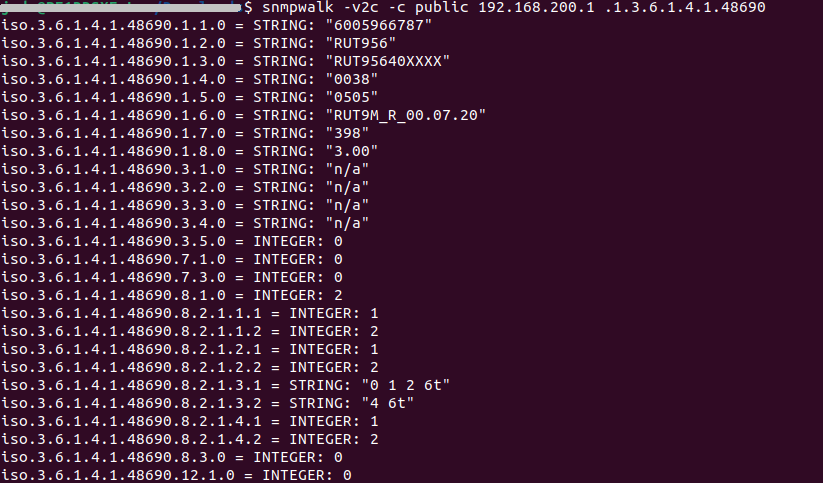

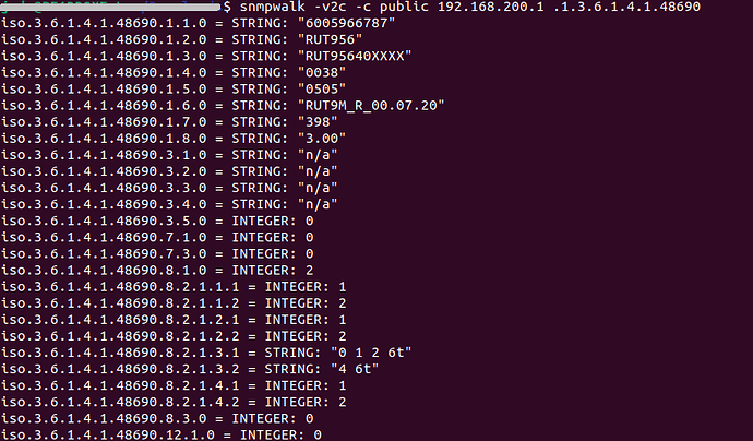

I’m using command line (Debian 12) snmpwalk -v2c -c public 192.168.200.1 .1.3.6.1.4.1.48690 to get the information.
Here is what I’ getting nothing less nothing more.
