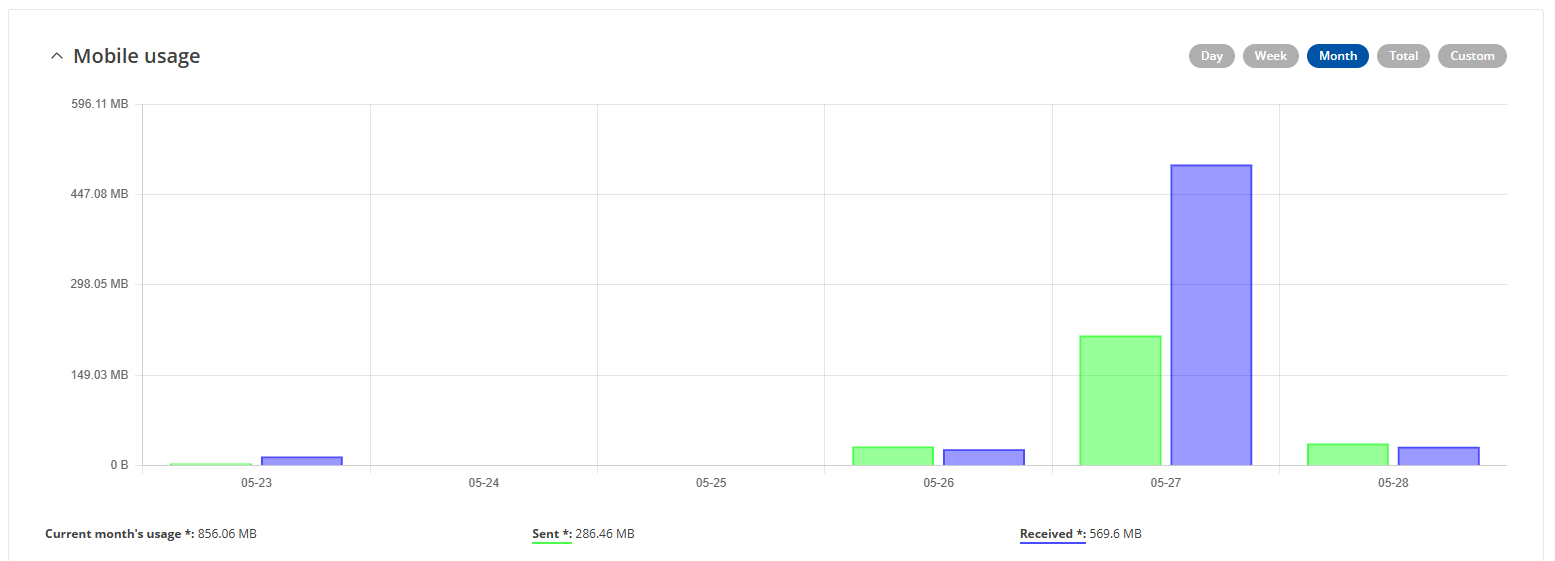

Is it possible to keep the total current month usage with a specific OID ?
Because I can have sent or received for today, week and month but I can’t have the additionnal data like the web interface.
Have you a specific OID for this info ?

Yes I downloaded this MIB but I search how I can have the total of send + received like on the picture in the bottom left corner.
Have you the OID for this data ?

Currently, this is not something that we have or can offer away to get around. I will, however, inquire with our R&D on whether it’d be possible to implement.
I’ll get back to you once I have an answer.
R&D has responded, and they have marked this as a suggestion for the future. For now, unfortunately, I cannot suggest any other way to collect both the sent and received data in 1 OID.
Hello, ok thank you for your answer. No problem, I will see if I can add two data for the moment.
