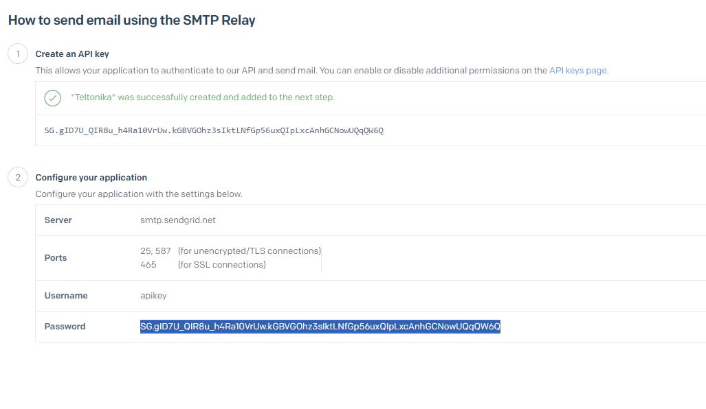

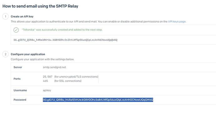

Starting to use SendGrid as our SMTP relay as our ISP will soon stop.
However SendGrid creates a 70 character password (that cant be changed) but the Teltonikas only support 64 characters.
Guess this is a feature request to enable more characters and/or see if anyone has seen a solution to this.
*note that the above API key / Password is no longer valid :wink:
Cheers
802 Group
Anyone? Support Team?
Currently, we have a maximum password length of 64 characters for SMTP services. Since most SMTP service providers also use passwords of 64 characters or less, we haven’t considered extending this option. Thank you for bringing it to our attention. We will investigate this further.
