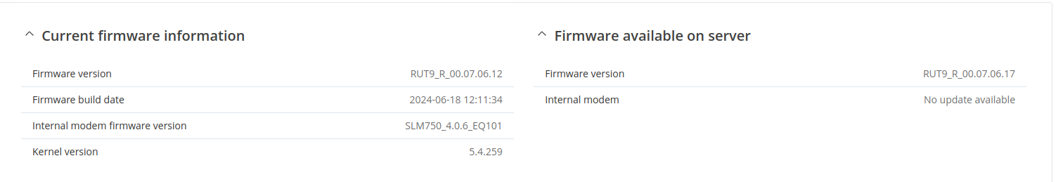

Hi @MatasR ,
This is my current firmware version an the last available:
Current version: RUT9_R_00.07.06.12
Last available: RUT9_R_00.07.06.17

Like I said, I am not on 7.6.17 but on 7.06.12. and the latest version that is available for download is 7.06.17.
Is 7.06.17 actually 7.6.17?
Best,
Ninoslav
Sorry, looked at the wrong side of your screenshot, 7.06.17 and 7.6.17 are the same versions, I’m just skipping writing the zero for convenience’s sake. You can update to the latest version and try again if that doesn’t work - kindly wait for a response from me whenever our R&D answers my query.

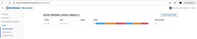

Hi Matas,
One more thing, when I want to create API access token in RMS, I only have scope for these APIs:
I dont have possibility to choose the scope of these APIs:

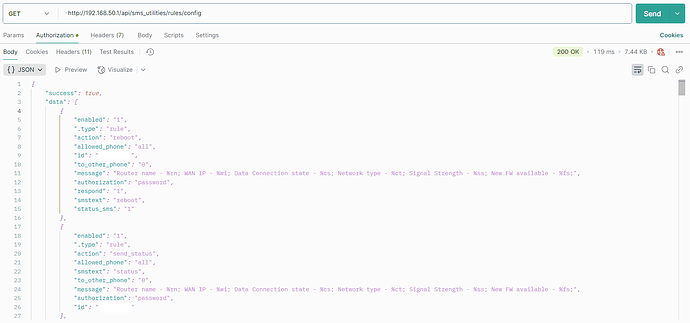

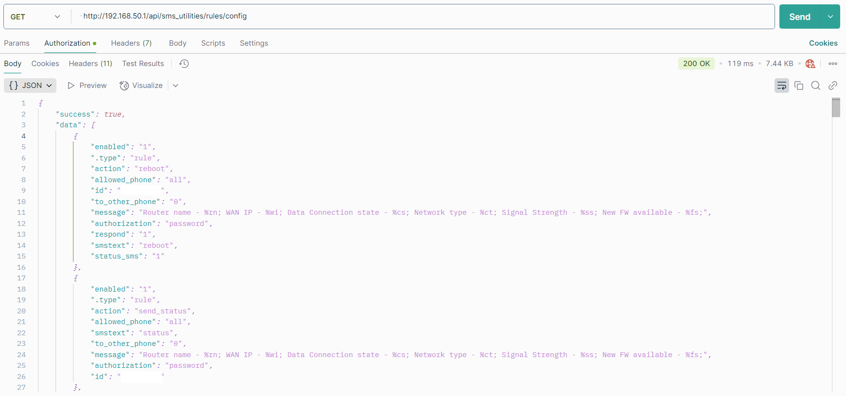

In short, this is the response I’ve received:
“The client seems to be using an RMS API call endpoint, that doesn’t exist. You can check available RMS API endpoints here: API Reference | Developers. Instead, for getting SMS rules configuration he should use the endpoint from the page you’ve provided here. Even though the API developers portal is still presented as BETA, the specified API endpoints work as intended.”
Here’s a screenshot for reference:
Regarding the scope of APIs, this is sort of answered in the reply that I’ve got. RMS doesn’t have some (or even most) of these calls, only those you see in the developer.rms portal. The ones that you are trying to use (eg.: SMS utilities) are separate.

Ok, but in my RMS when I generate access token, there are no sms_utilities in the scope of the token.
Ninoslav
As seen in the developer.rms portal, “sms_utilities” is not present in the scope, that, I believe, is intended to be the case. As mentioned earlier, if you want to set up SMS utilities using API calls, you’ll have to refer to the Developers portal.
Hi Matas,
You are not getting what I am saying, when I go to my RMS portal and want to create the access token
under the scopes there are no API calls like sms_utilities and others.
Ninoslav
As mentioned,
SMS utilities are not a part of the scope where you’re looking.
